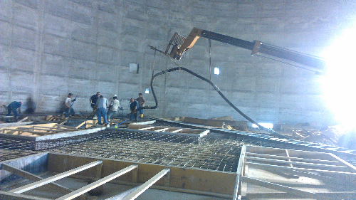

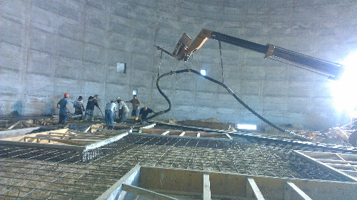

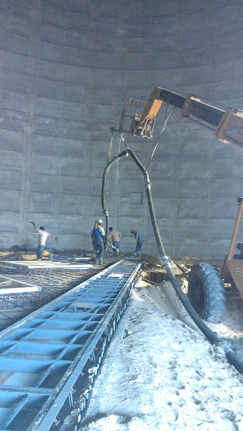

this ofcruse did NOT work out lol! |
| angie | 04-18-2013 | reply profile send pm notify |
duh! |
kinked every stroke! |
| dlee7729 | 04-18-2013 | reply profile send pm notify |
Get er done. Hard hats are a option boys. Nice looking pour and just right for a small boom . |
| AZ pumper | 04-18-2013 | reply profile send pm notify |
I think I would have used 2 pipes to hang on that forklift.
| Mister_Perkins | 04-18-2013 | reply profile send pm notify |
If you hang them at the colars theres less chance of kinking |
8.5hrs for 64 yrds. thanks to the rednecks that didnt wanna listen to a girl, they went home with sore backs while I was counting green backs!!! lmao :) |
| hammah | 04-18-2013 | reply profile send pm notify |
Run a 90 before the last hose no problems do it all the time on excavators run it like a boom! |
