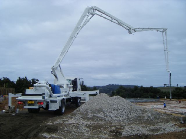

We have sold several used ones and a new one a few years ago. All the guys that own and operate these pumps love them. Look for a pump with a minimum pumping tube size of 4.5" and with a vacuum system. I reckon the best ones are the pumps with 5" pumping tube and vacuum system. |
