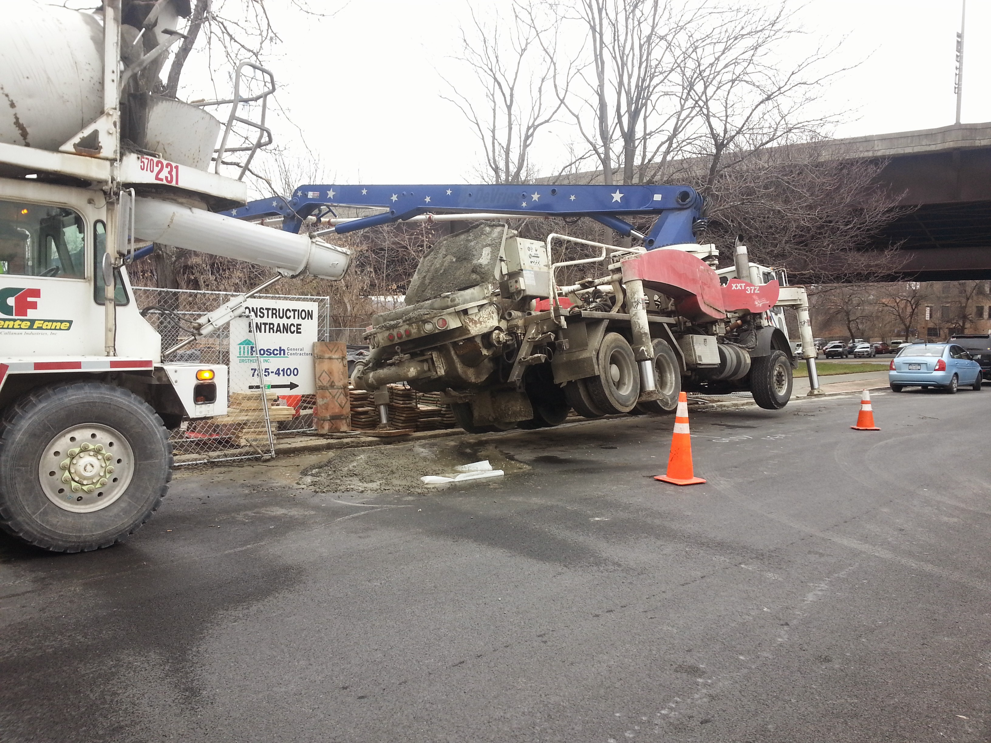

| jschsc | 01-31-2015 | comment profile send pm notify |
bank gave out. about 5 guys were jumping off wall fast as they could. nobody hurt but the forms. |
| lucky phil | 02-01-2015 | reply profile send pm notify |
back outrigger looks no where near fully extended |
| PUMBO | 02-01-2015 | reply profile send pm notify |
Misleading topic, I came here looking for some money! |
| PedroALL5Z | 02-01-2015 | reply profile send pm notify |
This should read " made an account to sewer my competition" Funny how the account was made yesterday. Im all for being open about incidents so we can move in a positive direction and more importantly learn from mistakes in our industry,but creating an account to show this ususally means the poster is being sneaky and not up front about his intentions. Everyone has their shit days and none of us should point fingers. especially hiding behind made up bogus accounts.
Also how could the bank give out? The rear outrigger appears grossly shortrigged and the machine hasnt dipped an inch? if a bank gave out this pump would have its O/R on the passenger side 5 feet up in the air. Looks like a poor setup. Either way show some balls and post from your legit account this is lame high school girl shit!! |
