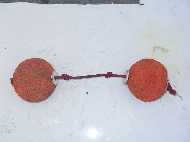

| 16 CELL | 12-07-2009 | reply profile send pm notify |
try this setup... we used to get buildup in the deck pipes using only one square sponge, no longer an issue since switching to this setup, and priming has become much less "eventful"... It's a bigger investment up front, but theses round sponges seem to last forever... as long as you don't chop them in the hopper |
| mudcup | 12-07-2009 | reply profile send pm notify |
I like 2 use the square sponge better seams 2 wipe the pipe better.People r always asking me "how much water it takes me to clean those pipes" and they r always shocked at how easy it it when I suck the sponge back. |
that's why you pack them around in your lunch box LOL... it's easier for us to monitor sponge usage/abuse because we are a smaller outfit, but I can definitely see how it could be frustrating in a larger company where there is always that "one guy" ... |
