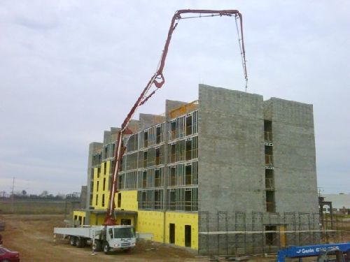

| Granite Pumping | 11-13-2008 | reply profile send pm notify |
We take 10mm rebar tack weld bars together across the main crate. We then bend the two pieces that run parellel with the crate which hook around the lift handles. Easy to remove or put on depending what your pumping. We have a 2" line running of our booms to pour cynder block works great to keep the fins out bigger than 2".
| Bob | 11-14-2008 | reply profile send pm notify |
The removeable grill is slick. Where do you store it between uses? Does it stay on the pump? Do you have a drawing for the other members? Sounds very professional, Thanks ;~) Do the mfg's have smaller mesh size grills for 3/8" material? |
| Granite Pumping | 11-14-2008 | reply profile send pm notify |
When we are done using it, it sit nicely in the tray behind the boom saddle. Whole thing weighs about 3lbs.. Cost $10.00
