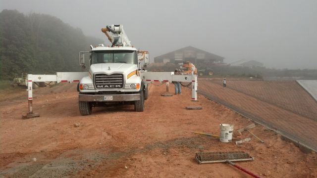

Bought this used 32 meter schwing in march...on this pour, with this set up (pic was taken before outriggers were fully extened) With the boom fully extended and concrete moving through the sytem, the right front outrigger kept lifting of the ground three to four inches. On other jobs with similar setup, same problem... any suggestions would be appreciated. ..ty |

That is not an X frame, so it will flex and twist a bit. I assume you are working over the drivers side and the front passengers side outriggger is coming off the ground. You could get the frame of the pump checked out for peace of mind. Just put down the passenger side outrigger so the pump doesn't rock and keep on pumping. Sorry on real help

start first lifting on level with both front outriggers and than put rear outriggers on grund ,leveled. maybe it works for you too |

I used to run a putz 32 meter with the short back legs when i was working over the back the front outrigger would always come off the ground about 6-8" 32m is the top end of being on a 28 meter footprint it wont go anywhere but i would always watch it very closely when I would operate. Your not doing anything wrong its just how it is. Get as close to 3% as you can so long as the bubble breaks the 3% line you'll be good |

I've ran pumps with those same out riggers for many years. Everything from a 28 up to a 41 meter. To be honest its the nature of the beast to have some out rigger bounce on the oppiste side your pumping on.
I actually thought Putz said it was normall to have up to a foot of out rigger bounce on the oppisite side. Maybe someone could correct me on that, but I thought I read that in a old 1988 putz operators manuel.
When I would be pumping flat out on one side of the pump. I used to place the out riggers down on the side I would NOT be pumping on first. Then set the out riggers for the side you ARE pumping on. So, you can raise that side of the pump up more. Not alot just a few inches. You will have to play around with it. Good luck |

I made it a habbit to stretch the boom all the way out the direction I am pouring and chack the out riggers. But even at times they will still come up a hair. |

most of the time if you preload the outriggers quite a bit, front tires off the ground, it will not sink down anymore. you have to just be observant of the ground conditions before setting the pump up. I always pre load all my outriggers.. push the outriggers down until the tires come off the ground and the pads don't sink any. if they sink, put more dunnage under them until they sink no more |

Outriggers Float: It's the nature of the beast! You can't preload for ALL positions! There's too much engineered flex in the frames, like in the booms. Without it you have breakage. I set my fronts (38m) so most of the weights is off, and then lift the rears about the same; adjust when nessesary! Bigger booms (52 ups) I set the rear level crossways and lift the front axle off the ground, depending on the stretch, I might lift the two fronts! |
