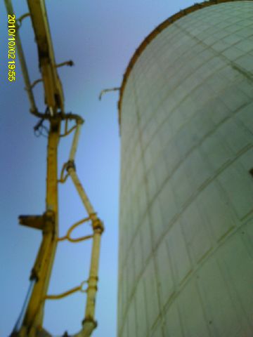

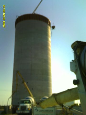

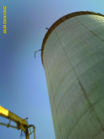

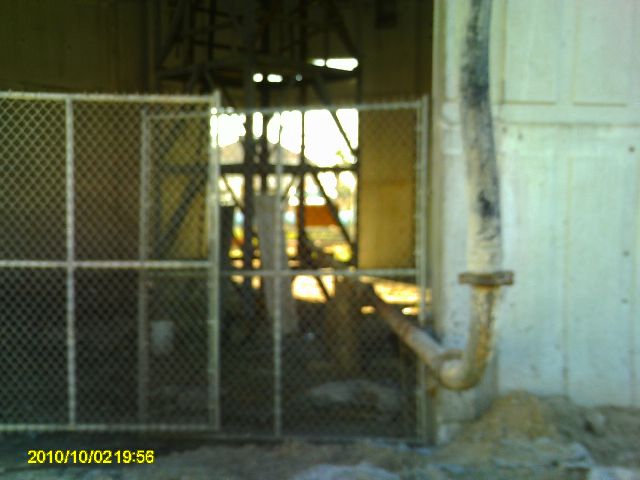

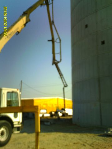

Just a few pic's from a water tower base we have been pumping (sorry, I don't know why they are a little fuzzy ) 32m Putz pluged into a stand-pipe, with a Texas boom hanging from the crane. Located at Jamaica Beach, on Galveston Island, Texas

yes why use the boom, couldnt you come straight of the back of the pump |
| Grizzly | 10-03-2010 | reply profile send pm notify |
Not possible due to site space...could not even get a trailer pump on that side of the job. But, they only got charged for a trailer pump. Sometimes you gotta do what you gotta do. |

Seems to me another 80 - 100 feet of system and connect it to the trailer pump and you're golden. What could possibly prevent this from being the case? Need to maintain access for men and equipment over the pipeline? Simple - bury it. This ain't rocket surgery, people. The boom overhead merely adds another dimension of risk. |
So much easier to just bring in the 32m and be done with it (it's only 50 yards per pour). Our trailer pump is always busy and is based out of our north yard 55 miles away, I am only 18 miles away with the 32m. |

my problem with a texas boom is when it is directly hooked to a boom pump with just hoses in between , a crane holding it off a stand pipe may not be the safest but is fine with me as long as the crane is well within spec and all safety concerns are met, from a liability stand point you may want to give them the position of the crane industry on the dangers of using a crane to hold texas booms , I do not know if the stipulations were on just tower cranes or hydraulic and crawler cranes also, ? but do know it is strictly forbidden with tower cranes.But this one looks okay to me. |
| pumpjockey | 10-04-2010 | reply profile send pm notify |
None of it is personal, just questions. Maybe none of it is anybody's business. Mostly just curiosity and wondering WTF? Too bad that the iron was discounted, but things are what they are. Nobody does anything they feel is unreasonable. Get the job, and get it done. As far as the Texas Boom up top, it doesn't (directly) pose any risk to the concrete pump on the ground. I hope that the system on the T-Boom was not yours, so that if the shit does hit the fan, you are more at arm's length. |
