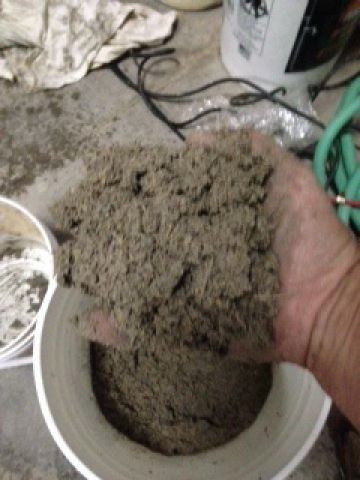

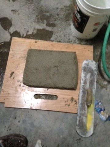

| b-alto | 02-03-2014 | reply profile send pm notify |
I made some up today with mortar mix. Its leaner than id like but what i had in the shop. Added about 50 50 mortar and saw dust i had on hand. Will see if it sets up.. |
| b-alto | 02-06-2014 | reply profile send pm notify |
Yeah, it didn't set up. Oh well |
