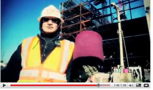

Here is Bob Stevens the proud Sponge catcher. Bad bad Bob.

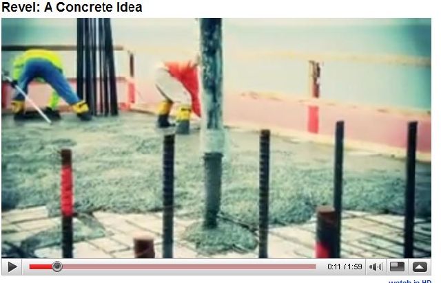

Here they are pouring with a double ended hose. Now remember everyone its ok to use a double ended hose as long as you have a single ended discharge hose connected to it. If you have to shorten your hose you remove one of your double ended hoses and reattach your discharge hose. |

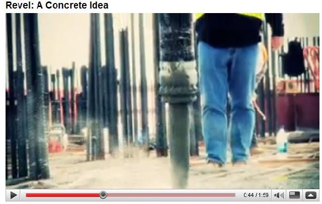

Ok here is a good shot of a discharge hose, the problem with this picture is that the discharge hose has a hole in it about 6 inches from the end. Concrete keeps spilling out of it. The big problem with this is that it could catch something and cause a blockage and spray concrete out the side of the hose and really hurt somebody. This hose needs to be fixed or tossed off the job. This is very dangerous.
