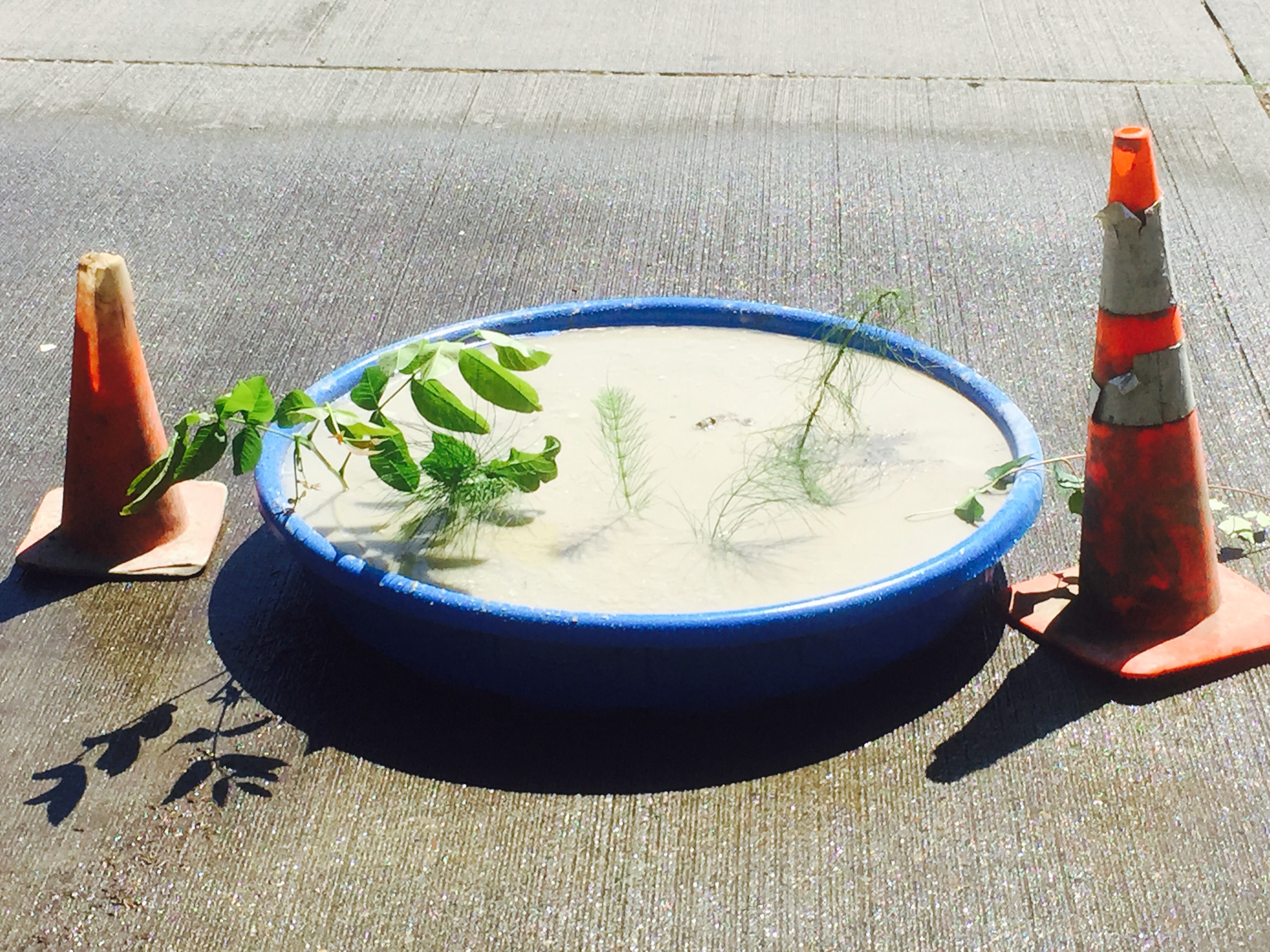

I showed up to a city job last week, it's 90 out. The maintenance guys outsmarted me they said, kiddie pool was only $4 at Walmart. Now I can't charge cleanup. After it drys their going to roll it out of the street (sure 1500#) anyway I planted horse tails and ivy in it to make a lovely city of Seattle street container garden, lovely right? |
