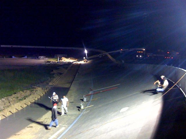

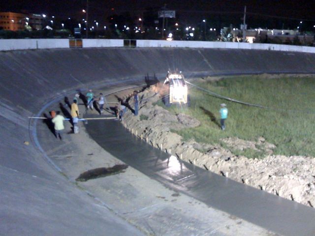

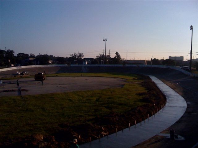

38m plus 300'3 and 2 1/2 in system 120 yds |
| pudg | 06-18-2009 | reply profile send pm notify |
all that smallline off the boom and the hoseman only got whipped one time a piece of hard concrete out the mixer hung rite at the end and turned loose thank god it wasnt a double ender,cause it knocked him on his ass ,and yes we was pumping very slow on about 1 1/2 on the volume control with a 16 cell |
| biged | 06-18-2009 | reply profile send pm notify |
pudz where are located that looks like a midget racing track. |
| C&M | 06-19-2009 | reply profile send pm notify |
I like your Hose Hog.....you should of welded a small boom on it. lol |
| Many | 06-19-2009 | reply profile send pm notify |
Ok pudg,I know sometimes things escape me.What the heck is it? |
| pudg | 06-19-2009 | reply profile send pm notify |
cycling racetrack 1/4 mile track |
