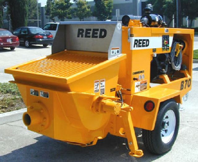

K guys ive ran into a few situations where ive received an unpumpable mix, did everything i could think of to get her going and she just wouldnt pump. I run a Reed B70 line pump with 2 1/2" hose... is there a general rule when it comes to unpumpable mixes? Like is there a rock content level thats kind of the limit before you need additives such as pump aid? if i was to look at the ticket of the mixer driver, generally should i be able to read that and know if the mix will pump? if that is the case what exactly am i looking for that will tell me if its obviously unpumpable

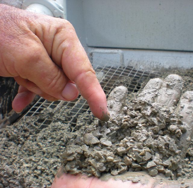

thats very similar to what i had on friday. we got the second truck to add more sand and less rock, and i had them both drop in some pump aid and it pumped better, still had plugs on occaision. But the first truck i didnt know it was unpumpable untill it was in my hopper and i tried to run the prime through...barely even made it through my metal reducers, we specified a pumpable mix but it most definately wasnt. I just want to learn about it so i can know by looking or reading the ticket. |

Mathew had it backwards. With pea rock mix, 40% rock weight and 60% sand, plus 5.5 bag and a bag of fly ash. Also when you get that kind of arrow head crushed rock? All bets are off. Good luck.. |
