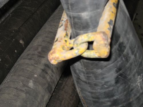

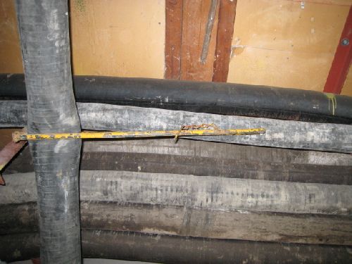

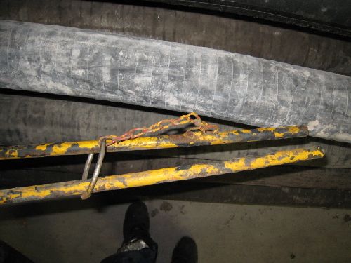

Here's what Vasa made... |

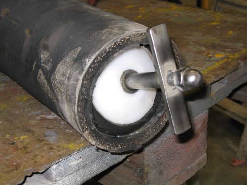

The above could be used to kink the hose off BEFORE the trimme pipe? Or you can use on of these to PLUG the end of the trimme pipe...... |
| Many | 01-25-2009 | reply profile send pm notify |
Pinchers were widely used by the last company (big) that I worked for.That was untill the safety department caught wind of it and banned the use. I have personally never heard of any injuries but I have seen boom movement that could take out one or two on scaffolding.An air cuff of some sort on a big job would certainly cut down on exposure to injury. |

OK guys, physically collapsing a hose with a mechanical device, folding the hose on itself & wiring it that way, or shoving something in the hose have great potential for hurting someone (or worse). If someone forgets about the plug in the hose end, or someone cycles the pump while the hose is folded & wired shut, you'll quickly find the weak link in your system over the placing/finishing crew's heads. That's why an air cuff, or air operated inline valve is the ONLY way to go. Say you close the valve with the maximum recommended air pressure of 90 PSI (which is MAXIMUM RECOMMENDED PRESSURE TO THESE VALVES, BTW) & forget it's closed, starting the pump without opening the air valve. What happens? You build to 91PSI or more of line pressure on the concrete, the air in the valve compresses & let's the concrete go by without catastrophic failure. IT'S NOT GOOD FOR THE TIP HOSE & NOT RECOMMENDED THAT YOU PUMP THROUGH THE VALVE WHEN CLOSED, but the beauty is that you are ‘forgiven for your transgression’ without having a customer go to the hospital or cemetery. Think about it…..GIVE THE CUSTOMER WHAT THEY WANT, BUT DO IT SAFELY. |
