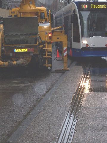

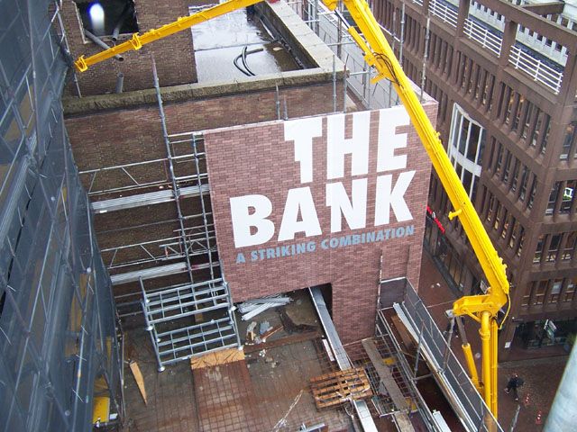

Here is was in the very center of the city in Amsterdam, almost no place to set up my machine
workers from all over europe no one spoke dutch and some spoke a little english. real amateurs had to explain everything they must do. only with the foreman I had proper communication
The job was done and that's about it. never again this way |

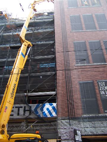

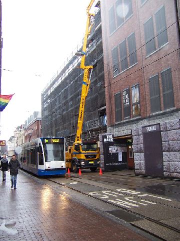

fold between the metro powerlines |

shortriggin because lack of space |

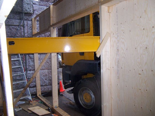

Bert has entered the building |

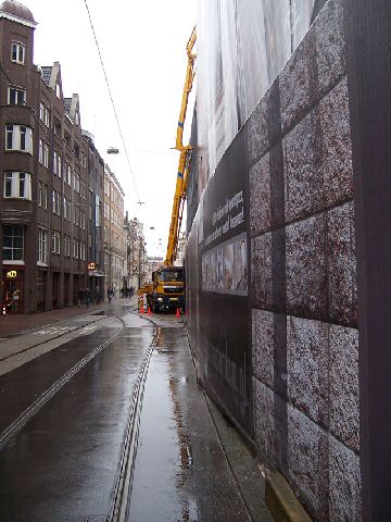

just in reach |

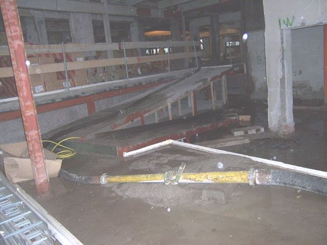

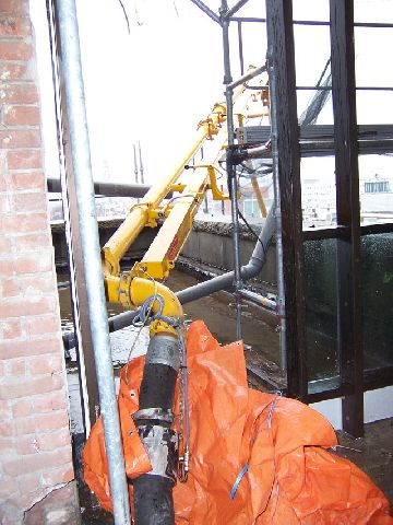

and fourty yards of hose |

it's lonely at the top |

That one shoulda been TRIPLE rate!! Just because a boom COULD do it, SHOULD a boom do it? I think that the job is better suited to having hard line in place on the side of the structure, then bring in a trailer pump when it's called for. Stay away from the damn powerlines, set the traile unit where there is better room. Blow back into a mixer when the job is done. BTW, just how did you clean out? |
| concrete canon | 07-27-2009 | reply profile send pm notify |
a hardline was to expencive they figured. I had to pump just one mixerload. Washout wasn't realy the problem I blew a ball through the hoses. And for the boom , I close my shutter and pump back in the mixer and then suck up my spongeball. I did the hopper washout elsewhere
| pumpjockey | 07-27-2009 | reply profile send pm notify |
So this was a one-time only set-up? I thought by the looks of it that it would be 10 or more. Then maybe the time and expense of the hard-line wouldn't be worth it. The risk involved around high-voltage lines and congested streets and traffic??? How much cost is too much if somebody's life is at stake? Or any of the other risks that could be reduced? I'm just sayin'..... But, good work in a tricky situation. The pics are great. |

hey canon, great pics, little freindly info for you. i've pumped quite abit between those types of trolly lines myself, in vancouver bc canada. the biggest risk is coming in contact with the positve line.these are usually dc voltage. they will blow human body parts off and unlike hydro power, there usually is no breaker system to trip the cercaite. it will also weld your boom sections together.your allawable proximity limits are small but the current will arcseveral inches 5 cm acording to the bc hydro course i took 15 years ago. pump on bro and a great job, well done. |

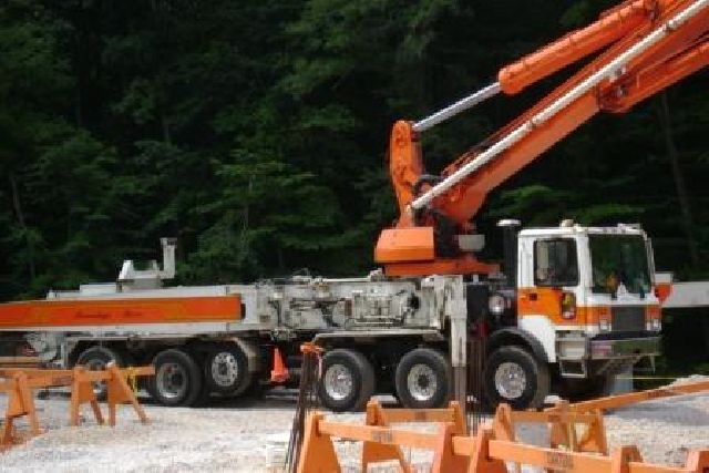

Unit 732 came from Oregon |

Yup, that one came from our yard. Very clean machine for it's age- |
| Nebuchadnezzar | 07-28-2009 | reply profile send pm notify |
yep, knew it looked familiar. |
| yard whore | 07-29-2009 | reply profile send pm notify |
hell ya I was really supprised at how clean it was! I love the old paint jobs they hold up soooo much better than the new paint and decals! The ole boys got some serious issues tho. Its a mud pumpin mofo tho. I got300 out of it yesterday in 2 hrs. What was its name when yall had it? |
