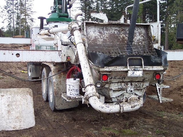

here's my big tip: use an overlay grate! it will pick up ALL of the crap that the ready mix trucks barf into your hopper and almost anything that does get through will be able to pass through your whip hose. since i started using this gem i have NOT had a blockage due to foreign objects and its been almost 8 months! |

I wish I had something like that back 8 months ago. Stupid driver threw my shovel in the hopper.
That was a good shovel. |
