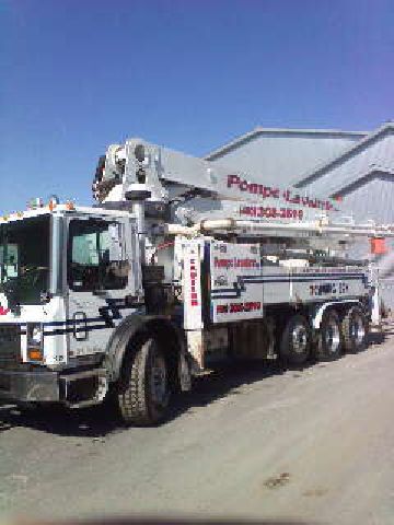

It has been a mounth and half that i work with my 39m schwing 2000.Overall pump is pretty good thanks Ed.I ve been trying to adapt to the way the boom was programm by the old operator.At first i tought it was me or the cold hydrolic.Now it is much warmer and i still have a hard time being smooth like i used to be with my older proportionnal pump. Lowering the boom 1 was very gnarly ,i mean nothing on the stick and then bammm!! it drop and pretty much the same with the right slewing and in and out with boom 4 So i decided to ajust the parameter:Treshold,start pvm and max pvm.For the 2 others param i don t know it does!I put at min the treshold Lowered the start pvm to the min and in the end i lowered the max pvm to help me. Long storie short,i end up slowing the boom to the slowest i think.Thankfully the rabbit speed works. Last week ,I ve been told to change the solenoids.This morning,I took a look at the controle block and saw that boom 1 and boom 3 solenoids have been replace.I don t know when but they look younguer then the rest.So it put a doubt in my mind .Could it but me that don t find the right set up or is the Joystick that are getting old,solenoids....VALVES....PUMP......!!
I never work with a brand new pump so i don t know how it should work.To what i believe a PROPORTIONAL sould work from 0 to 100% Not only a part of it and trying to figure out what s the best compromise. Thanks Tiso |
