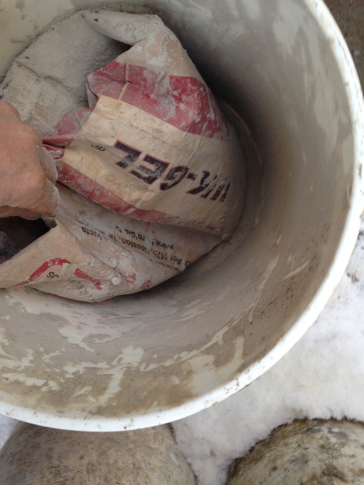

| b-alto | 12-15-2015 | reply profile send pm notify |
Nope, two buckets of quick gell.

| b-alto | 12-16-2015 | reply profile send pm notify |
Well drillers quick gell bentonite. One ten dollar bag does about 20 primes. |

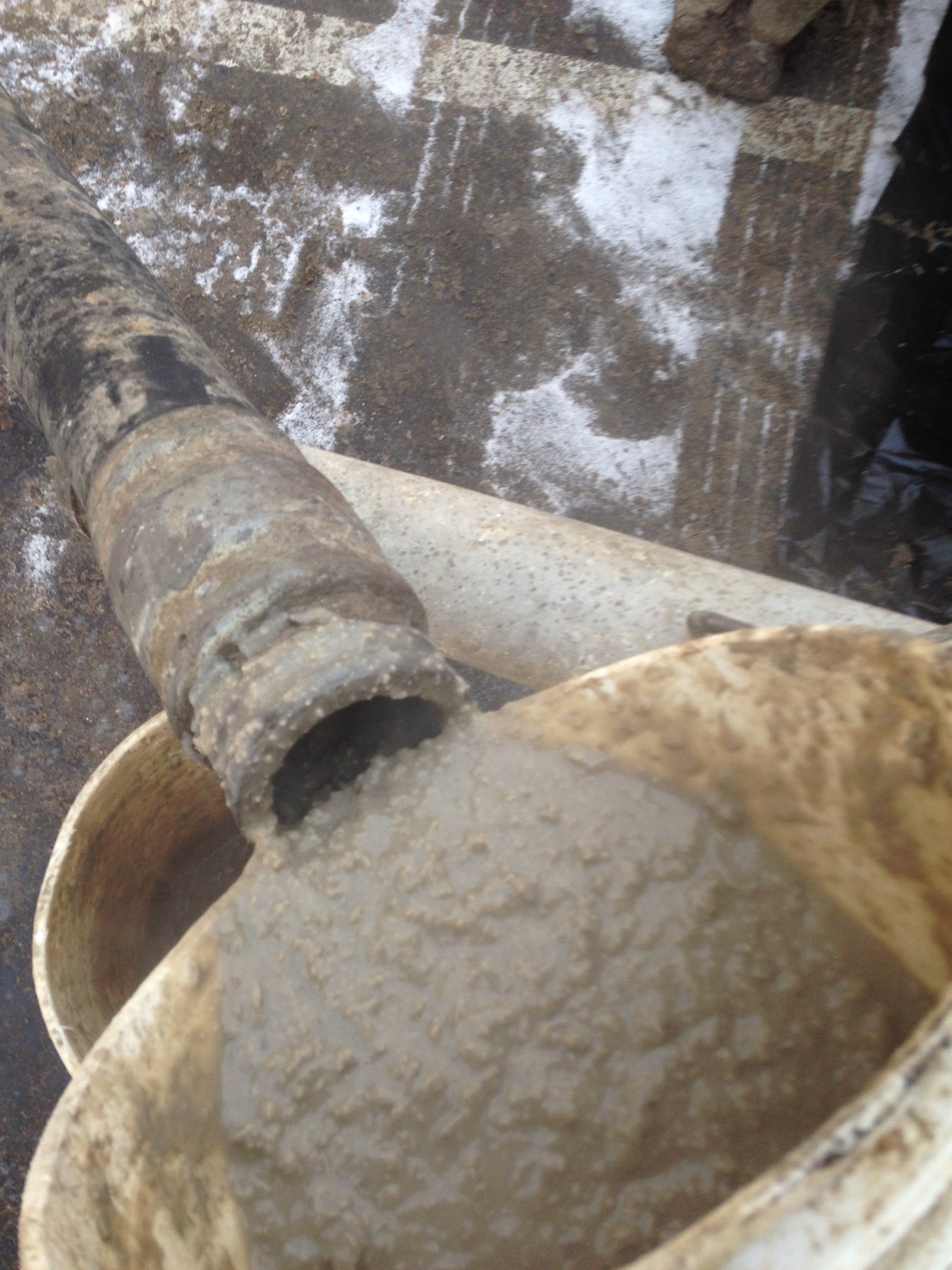

| BCCP | 12-16-2015 | reply profile send pm notify |
I don't, I use about 1/8-1/4 gallon of betonite and fill the rest of the 5 gallon bucket with water. Then put my 5-4 elbow on and dump the bucket into the valve and put a sponge in the 4-3 and then fill the hopper with concrete and pump on as long as it's not a shit mix it primes everytime. I think we use cetco super gel-x, I can check to make sure that's what it's called if you're interested. |

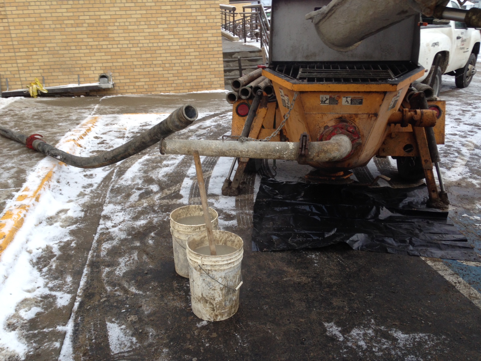

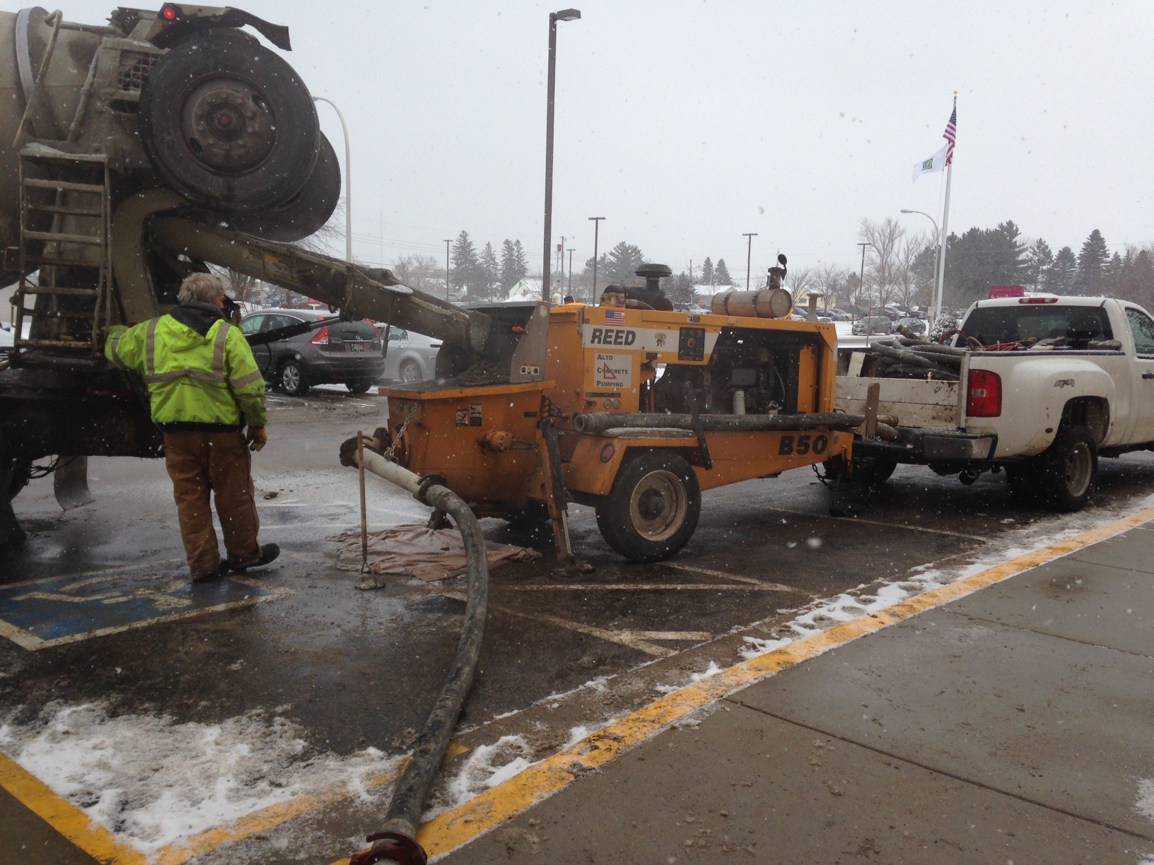

| b-alto | 12-18-2015 | reply profile send pm notify |
Here's a job i did this morning, 150 feet through a window and down 8 ' no problem. |
