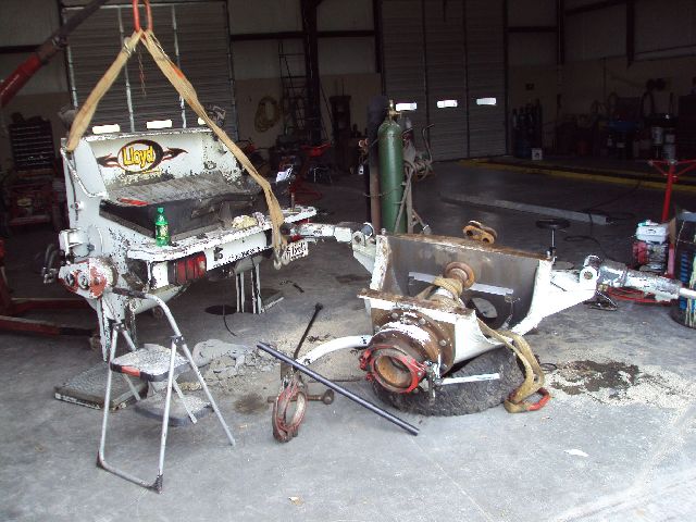

Did you bring home some concrete from your last job and make a concrete rest for your lower hopper? I've never had to put new material cylinders in yet. Nice photo's. |

Stop takin pictures. Put er back together. Phone is ringin off the hook. |

Nice work PourItOut , looks like you got your hands full. Do me a favor or your next boom inspector a favor. Before you reinstall all the parts, clean and double check the channels the hopper fits on and make damn sure there are no weld cracks, also do the same around the rear rest and the rear steps.And tie downs in that area. Since the hopper is off , those weldment areas are a breeze to repair now rather than later. good luck on the reinstall,its looks like you know what you are doing . |
| PourItOut | 05-17-2010 | reply profile send pm notify |
My 1st sermac tear down,,, definatly a challenge |
