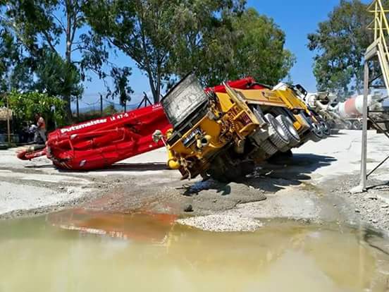

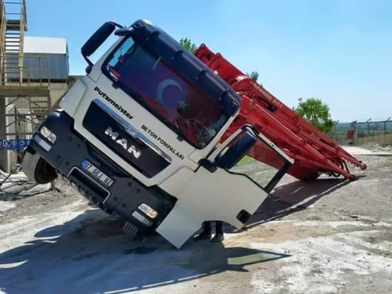

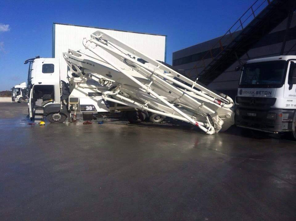

First 2 look like the operator didn't put the boom outrigger switch in the neutral position while washing out the 3rd not sure just looks like stupidity. All three just look like someone got distracted by a squirrel |
| ATM14 | 04-25-2016 | reply profile send pm notify |
Unfortunately, there isn't a way of making these machines completely idiot proof, without making damn near useless. Proper training and technique, while avoiding complacency is key. Looks like a decent amount of short rigging, lack of proper dunnage placement, improper outrigging setup, ect. |
| pudg2 | 04-27-2016 | reply profile send pm notify |
we are calling these guys idiots , but surely none of us know what really happened , how many times have all of you raised the boom to washout without putting down the rear outriggers ? me myself I have done it thousands of times, one time I had a swing brake fail and luckily I caught it , I was on a slight angle and the boom drifted luckily I caught it before it got completely over the side , I have also encountered a joystick short out and take off swinging right and would not stop , only thing that saved me was the estop system .So its not always idiots , may be in all these cases , but every now and then mechanical issues can cause accidents. |
