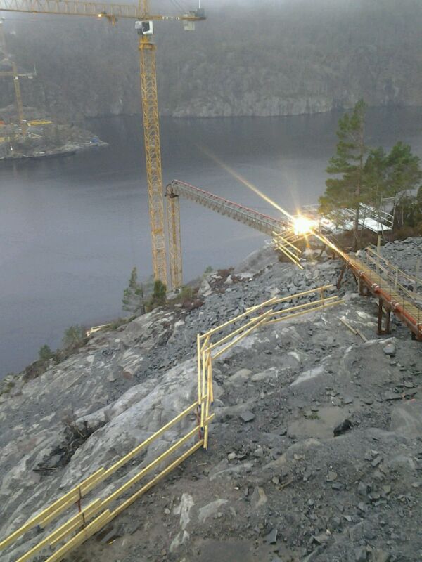

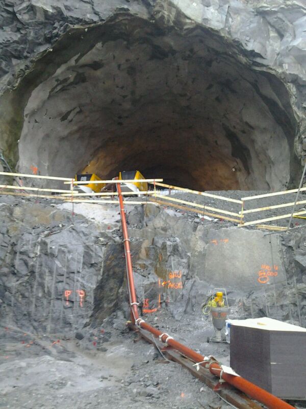

Here a little update of the project. Dipstick and me done already several poor’s, no problem whit priming but in the first concrete that come out of the line we have far too much air. We are busy whit fine tuning. One of the towers we hope to be on top in a few weeks and then starts another challenge. because one of the supers told me between the lines that the bridge deck will be made whit some amount of lite weight concrete
