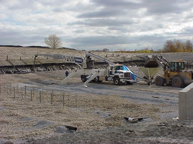

| whole9yards | 11-27-2012 | reply profile send pm notify |
I posted a "Tricks" article that might help. http://www.putzmeistertricks.com/ BTW, the TB-105 is yours. It was taken October 19,1999 at Pearson Airport, Toronto. We were placing gravel on top of a membrane. This was for a holding pond for glycol run-off from de-icing aircraft. |

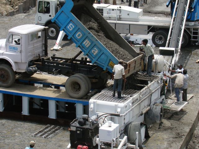

Or, if you have a LOT of sticky RCC, for a dam, how about the MAXON Maxcrete? BTW, I like the "Screen Machine," above, but getting a customer to pay for these extras is tricky. They all want it included in the rental rate. |

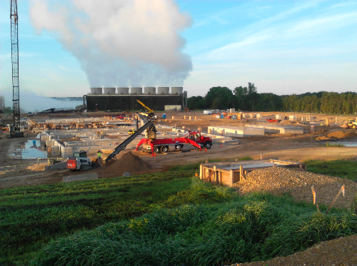

| crete | 11-27-2012 | reply profile send pm notify |
truck at power plant (test with mobile app) |

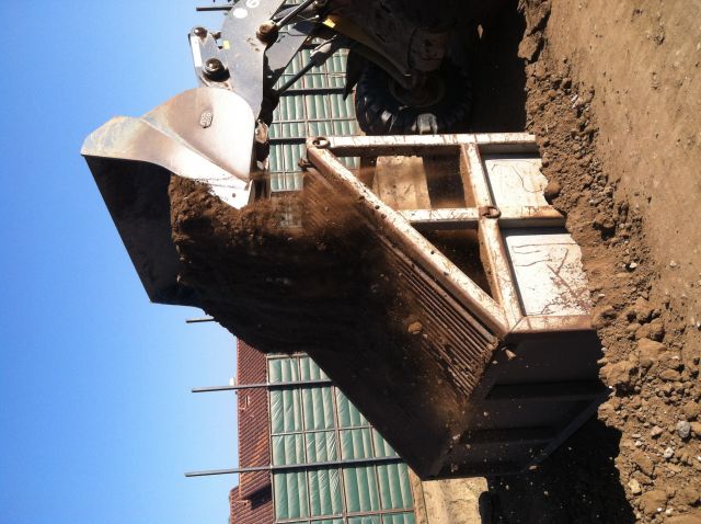

| northwest63 | 11-28-2012 | reply profile send pm notify |
A hopper with a hinged grizzly works well |

| therealdeal | 12-02-2012 | reply profile send pm notify |
After a couple of days of wearing out a couple customer furnished laborers, customer finally decided to bring in a grizzly. Much more productive. |
