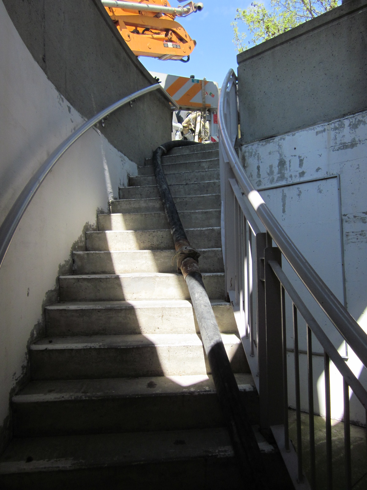

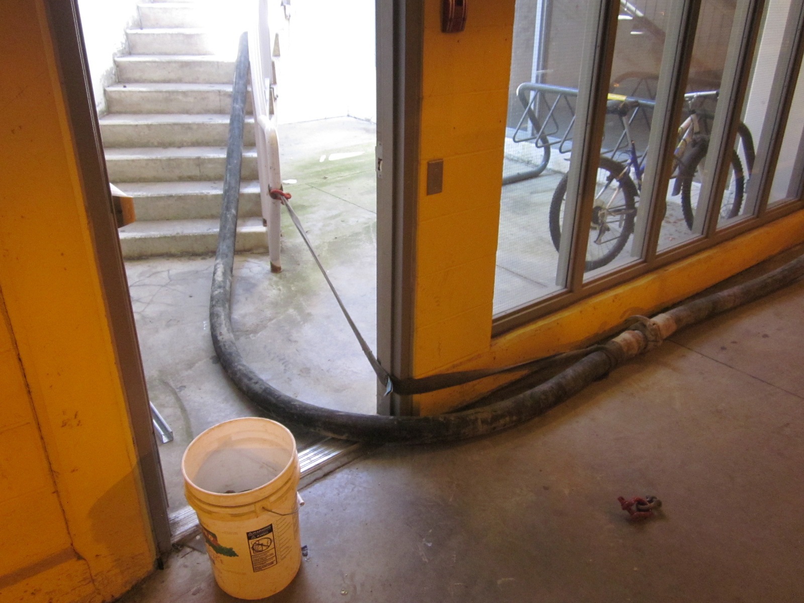

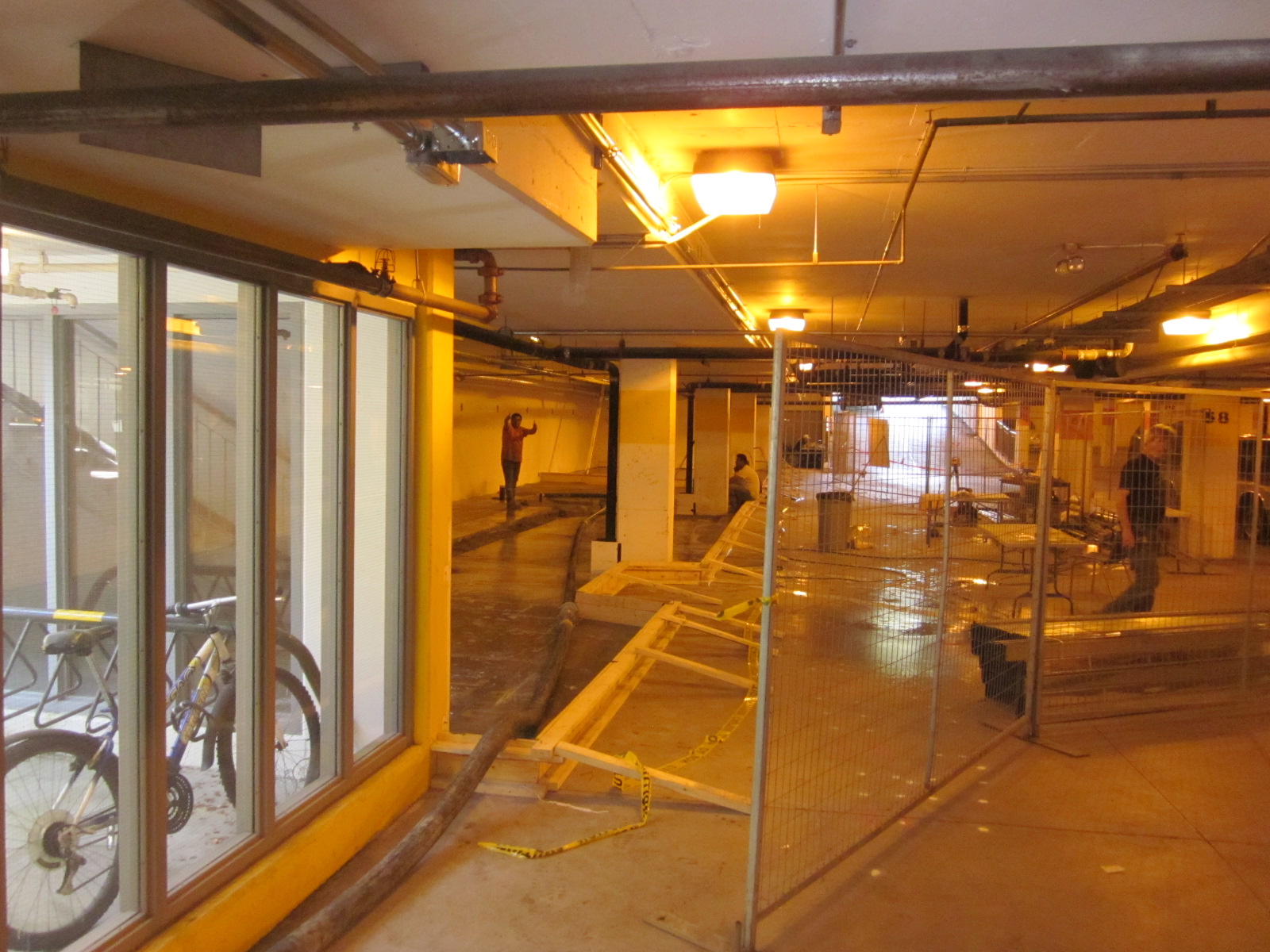

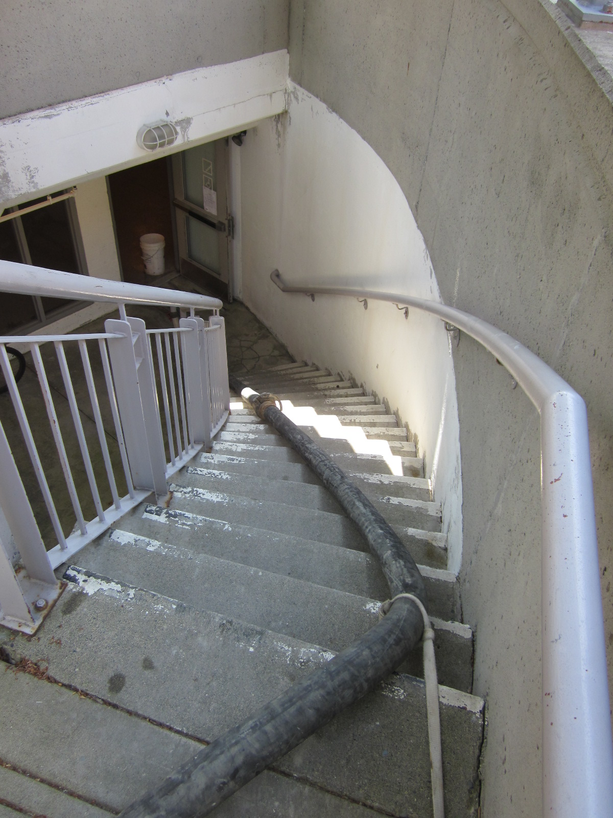

so we meet again pump
| ShortStik | 05-13-2014 | comment profile send pm notify |
best pump ever. bring out the boom exender. i got fat running too much stick. |

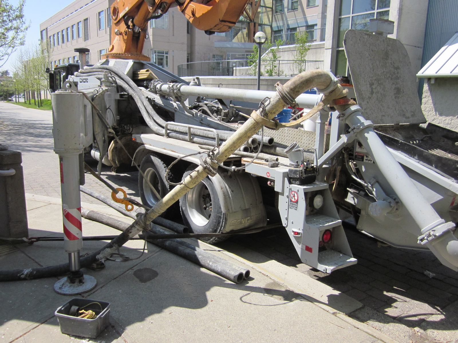

the high pressure 90 is lined up perfect (essen trans door and 90) so dont what to mess with it and hate having a 6-5 sticking out the side. i also like the mobilty of which way the reducers are facing.
| PedroALL5Z | 05-16-2014 | reply profile send pm notify |
that is also the best way to pump off the back end if you have an elevation to deal with like going in a delivery ramp.
