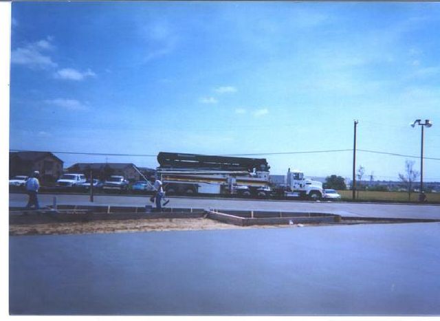

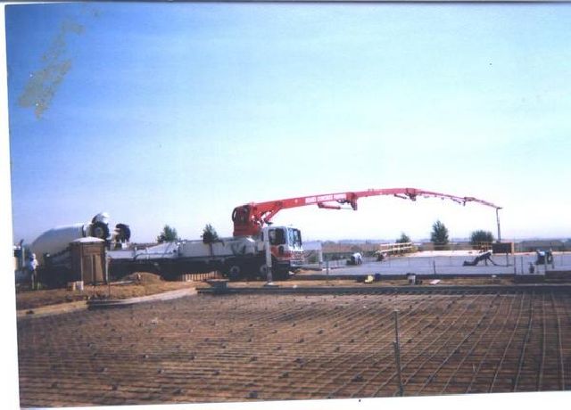

Nick, the first pick was taken in Dallas, TX after a long day of concrete paving with the 44M Putz, O'Brian Concrete Pumping and the second pic is the 42M Shwing that I operated out of Loveland, CO, Moats Concret Pumping |
