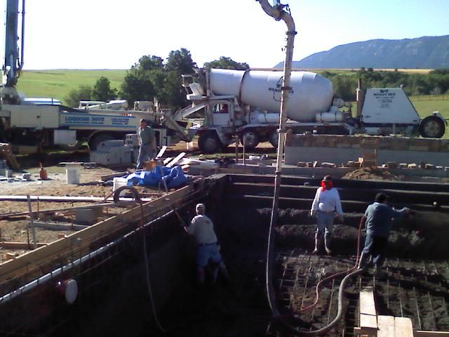

Cool pics I do quite a bit of shot crete but never out of the boom. Do you know the batch weights on the mix? Ry |

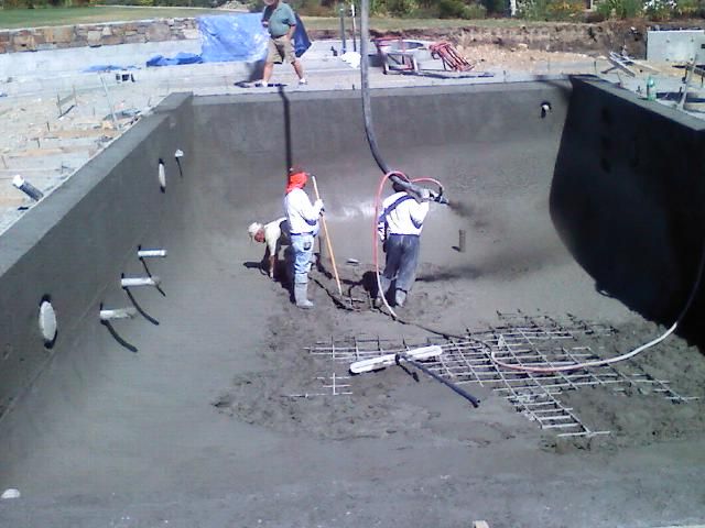

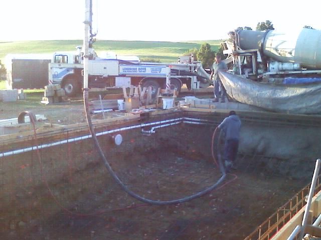

I dont know what the mix was but the first three trucks were so stiff the vibrat would not get the stuff through the grate. Had to shovel a bunch. Only a bit under the s-tub when I cleaned out. Pluged once at the nozzle and blew the rubber end apart but that was the only problem. These finishers were good and we got done in about 5 hours. I always try to go off the boom, it makes the floor at the end a breeze, you just hang the nozzle and they shoot it straight down. It makes an easy end to the day for the nozzle man and he comes out with a smile on his face. |

just finished two weeks of booming shotcrete .with reducers and nozel atached to tip sec 90 ,no problems.boomed 450 cyds.now back to no work. |

How does that last pic apply to the double ended hose rule? Partial plug and that guy is gonna be looking for his head. |

Man I'm surprised no one has said a word about it yet! The last pic. Last time I checked a shotcrete nozzle was metal and attached to a metal end on a double ended hose on top of the fact it has air pressure already pushing back towards the hoseman. Sorry dude, Never seen it done out of a boom. Guess it would be just fine if you kept the line on the ground. |
