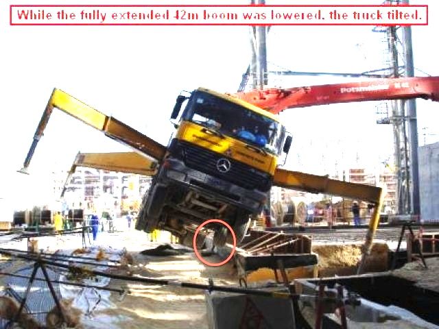

But are you judging by the picture,, If the nmachine tilts ontop of the rear swing out leg, it will stress back in towards the truck, maybe he had bad footing. Just saying. Easy to judge things and come to conclusions from looking at a picture, I do it all the time being a photographer also I take pictures from distances and it looks like my machine is cought in a spider web of power lines, you should read all the rocket scientists comments. |

It does look that way, but I have been to many flips or accidents, had a 42 on bad ground Operator error for sure but as the machine raised it looked short rigged, but the weight of the truck blew the cylinder and calapsed the leg back to the truck. Of course every accident is different, and looks can be decieving. Also Companies most of those times have not given enough trainning or information to new employees. What does he know and really who should be blamed in the end, every sanario is different, one picture can never explain it. but interesting picture. |

I know the picture looks like it was short riggeed, it just may not have neither the machine may have been over at the rear also, pictures are bad for judgment, but maybe the wood forms are not in the way also, almost looks that way also, who knows, point is I guess it was operator error indeed. |

it is blurry but if you look dirctly behind the driverside fron tires you can clearly see the foot to the rear outrigger. It is still on the pad/dunnage he had put on it it just swiveled when the truck went over. He clearly did not have it out very far at all. |

I'm with Dipstick and FunnyBoom. Definately short rigged on the working side. Please don't let anyone talk you in to attempting this. Stand up for yourself. If the contractor says "X company would do it," get your ticket signed and leave. Don't be a "hero!"

i don't agree with any of you guys. it "looks" shortrigged but maybe it wasn't at all. i have seen cases where the pump was fully outrigged, like i suppose it was in this case also, but the movements of the pump while pumping created an inworth moving of the outrigger. like you can ask TT a putzmeister 42m pump should be fully lifted from the ground, if you forget about it, the truck will jump up and down and it wil create a downforce in the direction of the outrigger. i know this can happen because i landed on a roof with a 42 myself some 15years ago, i was very lucky to not harm anything or anyone at that time. i stopped pumping towed the pump down with the mixertruck and made the full outrigger again this time tilting the machine completely from the ground and had no more problems. if i judge the picture this is what happened.
i think it is easy to bash someone just by judging a picture. |

We have all made our mistakes, some just get luckier than others. Pics like this are great because hopefully it will teach some of our "joystick operators" out there to respect the maching they have a little more,. Im not bashing anybody at all, hell i dont know the guy. But im not defending him either. I just hope nobody was hurt by this bad decision. I am no detective but i certainly can see the obvious here. If you look in the red circle you can clearly see the foot still sitting on a pad of some sort and the rod for the rear outrigger. The angle of the rod matches the angle of the lean of the truck. Your theory of the outrigger sliding in is shot down due to the fact that the foot is still on its pad, the rod simply just swiveled as it went over. |

i didn't say the outrigger slided. read more carefully please. the point is that the outrigger became ingrigged because the pump was leaning on it |

You said it could have had an inward movement... Do you truly believe that if this was the case that the pad that the foot is STILL on would have moved with it? Over top of the short curb and forms that the outrigger would certainly have been swung over if it really was fully extended?? Sounds pretty unlikely to me. |

This type of thing actually happens alot. More than likely his pour was in front of his truck so it was no problem to short-rig the rear because he planned to stay within the front outriggers... Then the contractor comes over and says hey we are going to pour this little thing over there while we have you here or we have extra mud lets put it here before you fold up... The rest is in the picture. Learn from it |

on the putz 42m the rear outrigger will collapse in when the weight of the truck is pushing inward, never saw one close completely though and stay on the pad, he was definitely shortrigged, we all make mistakes, if we learn from them is the question. |

If you look at the pile of concrete under the hopper it is directly under the hopper. Looks like a driver overfilled the hopper. And I dont know if this guy knew how to get the left rear outrigger over the footing and form next to that outrigger. |
