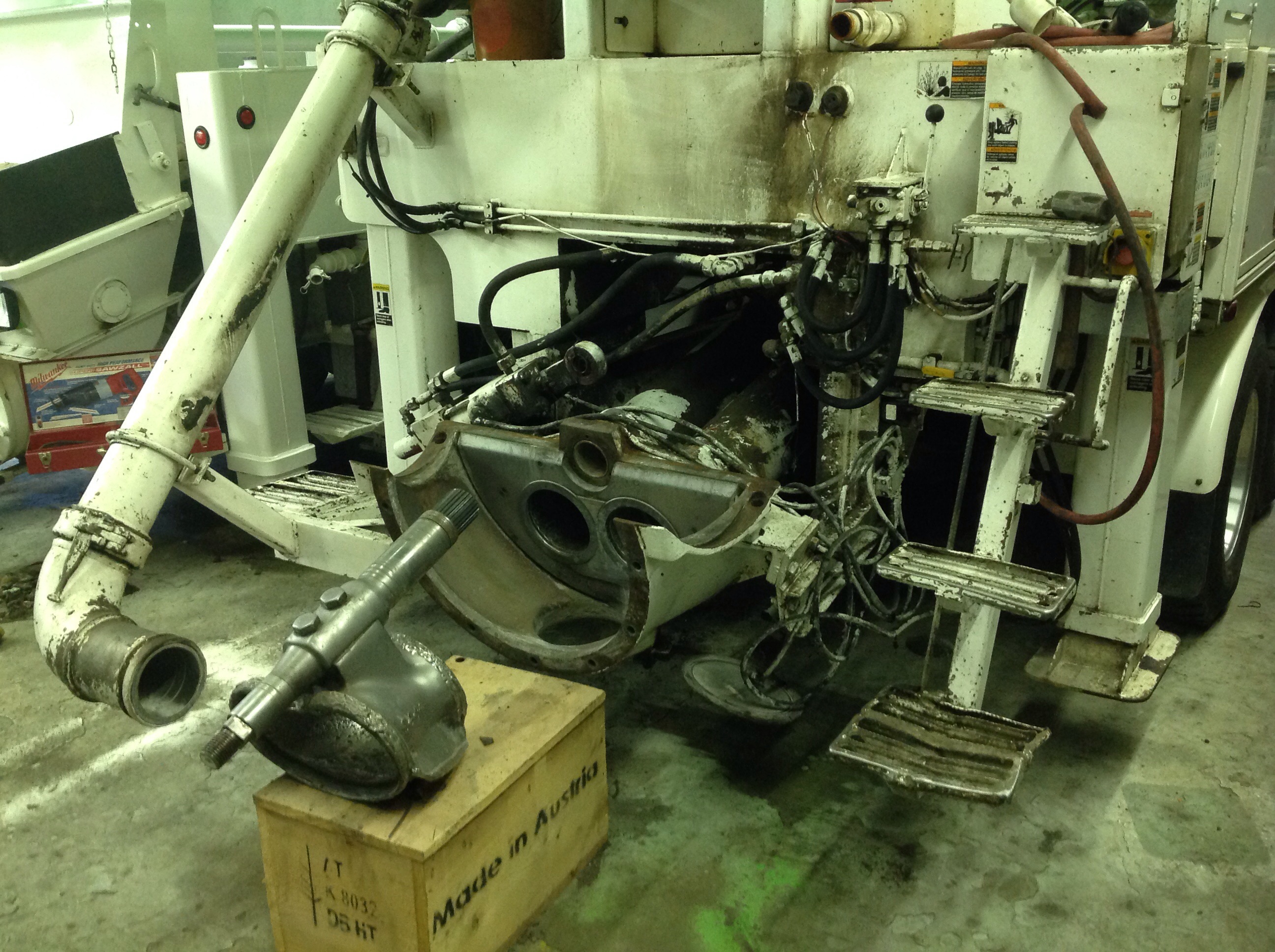

| MBB | 10-18-2014 | reply profile send pm notify |
Just finished one last Saturday, new bearings, o rings kidney seal, pressure spring |
