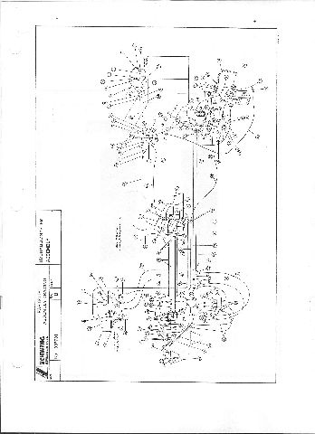

| typesdubs | 02-10-2010 | comment profile send pm notify | |||||||||
Looking for someone with a mid 80's Schwing 1000 truck mount (fast switch-single circuit) to follow the lines off the stroke limiter and tell me where all three of them go. Pics would be a huge help thank you. |

| markmark | 02-12-2010 | reply profile send pm notify | |||||||||
The line on front of the 1/2 block closest to the knob goes to tank. The middle line goes to the x or x1 of the regulator on the hydraulic pump. The last line on the back will be teed to the gauge. |
Geez, sorry about that awful drawing. It looked pretty good when I scanned it. Note: the last fitting to gauge means it is a supply line. The middlew is a signal port The first is a bleed port |
