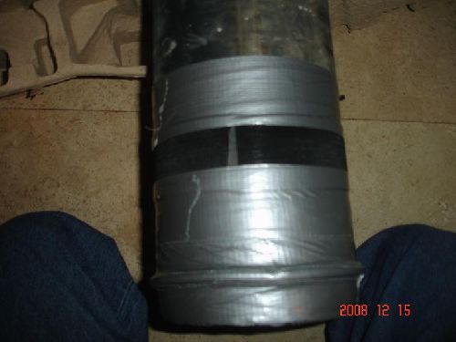

well this is what i came up with, a ring of cable held in place w/ tape

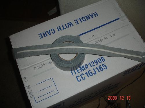

and a ring of velcro held in place w/ tape |

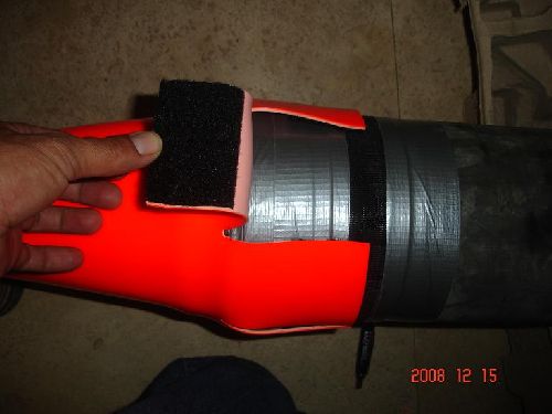

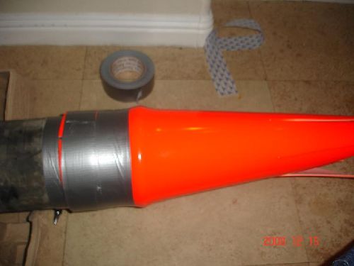

atach part 1 (the cone) to part 2 (the hose end) |

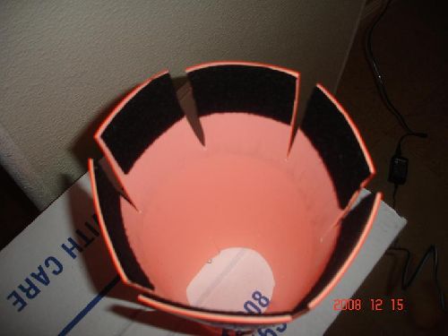

Looks good - who knows? Don't forget the slits in the bottom. Kris, When you make the slices in the bottom do you make them so that they are, when expanded, the same as the ID of the hose? |

secure just above the cable ring w/tape (notice were the ring is beneath the cone how it bulgges slightly) secure at the end of the cone were the velcro is |

were the slits start, is approximatley 4.5" |

Bob, I make the slits so that I've got a diameter of 100 mm. If I can pump at high volume I don't use the cone. If I need a very low volume I use a cone were the slits are shorter which results in a smaller diameter. |
