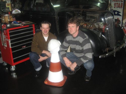

Thanks for straightening me out Too Tall, and if I do get of the right track you can still fix it with photoshop. Big Stick, operators like me with a little stick often have to pump at low speed for example 4 cm layers on flaps etc. On these jobs you have to pump at low speed so you can't fill up a 5" hose and you'll have concrete splashing around. In these cases I use the cone. Using a smaller hose would give me problems with plugs and releases under pressure. Too Tall, I got from Santa a new cone and a hard hat with integrated safety glasses. On the picture below there was no photo shop involved. This cone is not plastic but completely out of rubber. I just need to find the time to prepare it. |

Is that a '36 or '37? Plymouth? Good stuff! |

Raymond, the car in the picture is a Plymouth '36. It's not mine, it belongs to Dapper Dan, the man on the left. He bought it last year in West Virginia, shipped it to Belgium and refurbished it. He's passionated about old cars, concrete pumping and music.
