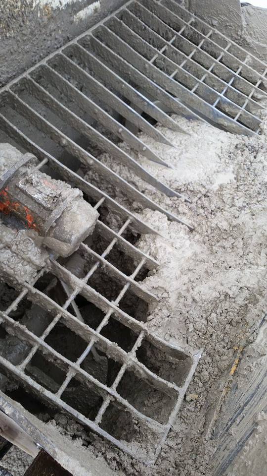

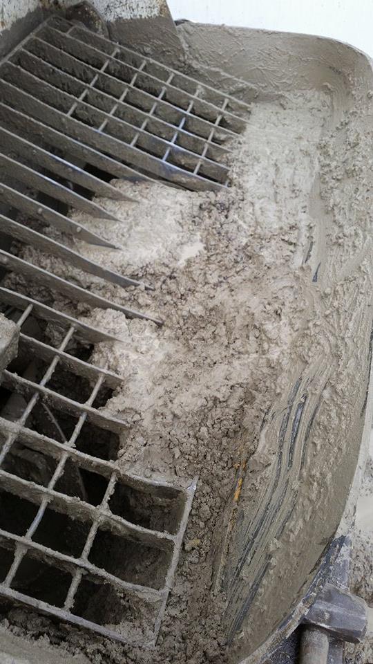

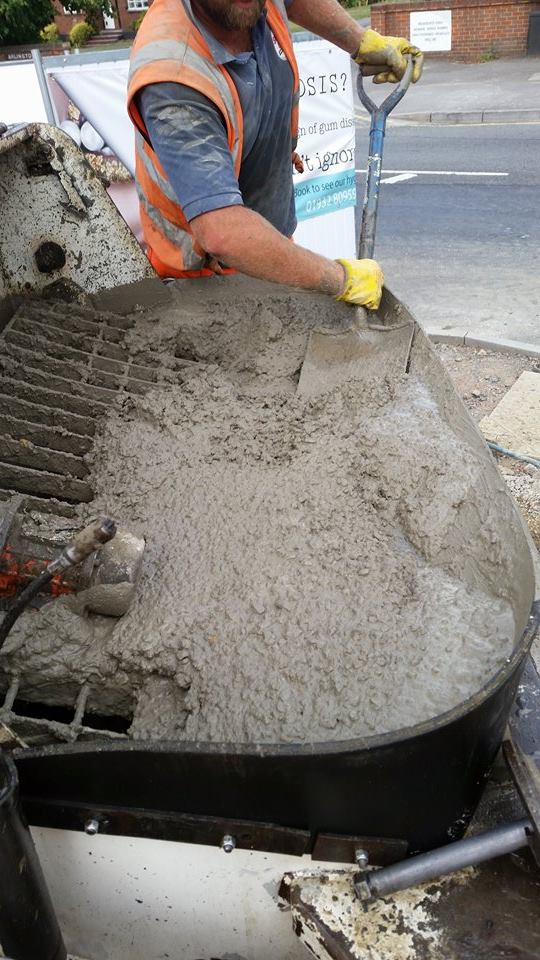

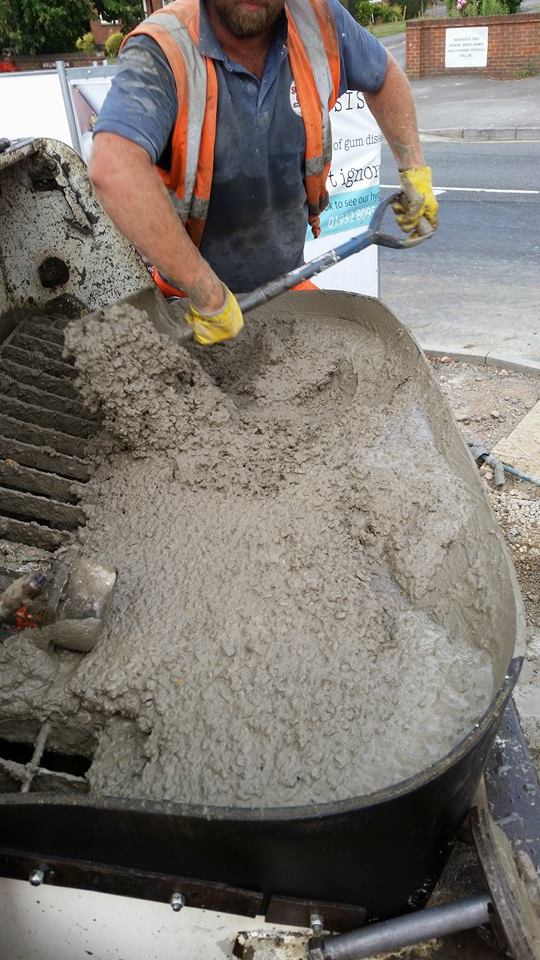

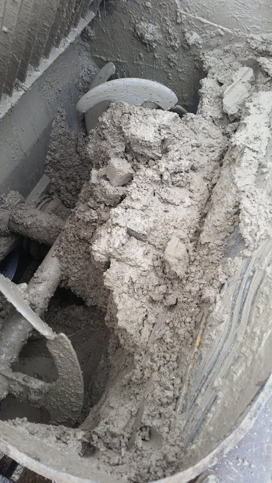

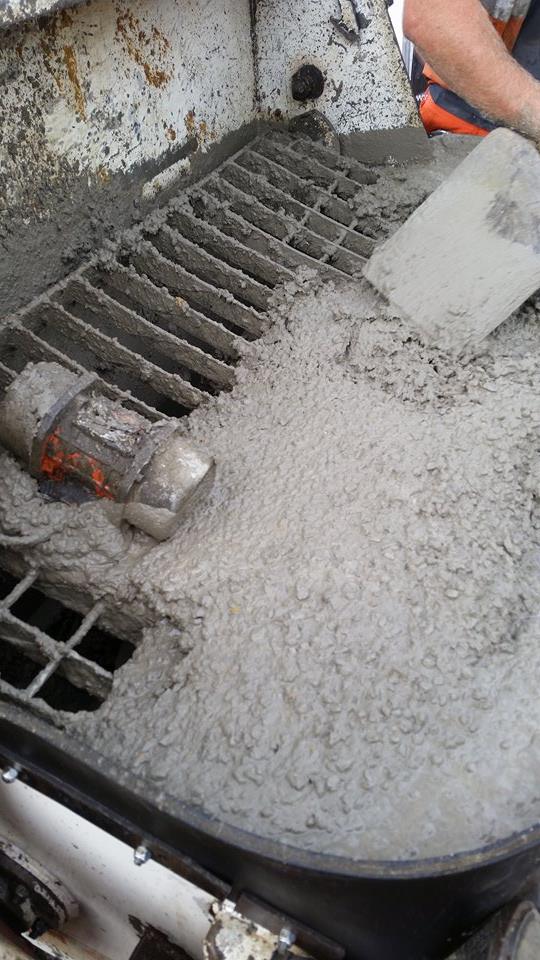

I'm out with a rookie who won't take my advice! Told him to pump the hopper down below the grille and just above the remixers to save it building up around hopper and bar it every 2 hours.. |

I'm sure I could have recycled that mud so I wouldn't have to do all the shoveling mud doesn't look brick hard just yet. Rookies are hard headed though. Turn your back on them and they think they know it all |

I would assume bar it means to scrape the sides of the hopper with a steel bar or stake. That is the way I learned, and it saves a lot of effort when washing out. Hitting it with water leads to seperation and plugging. |
