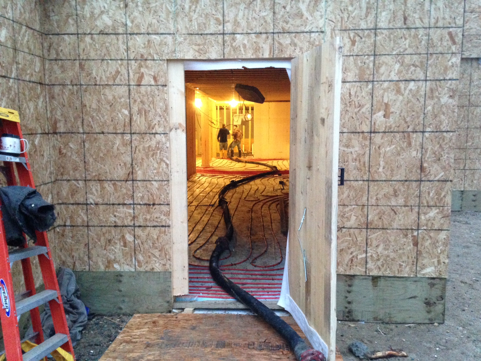

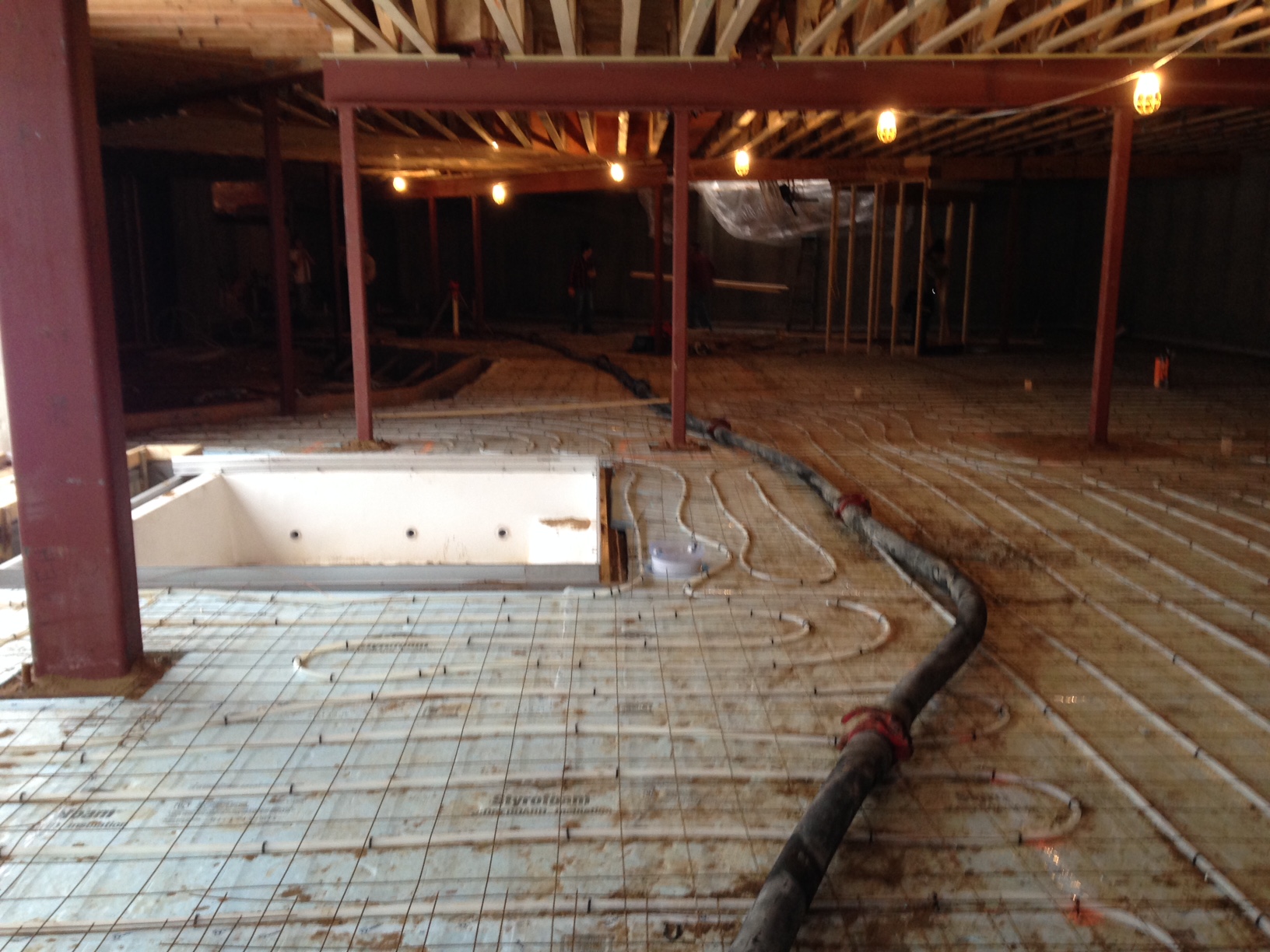

Wow, 8000 SQ FT basement. 94 cubic yard floor at 4". 250 feet of hose and pipe. I did it in two pours (pumps) yesterday and today. Straight #4000 mud pumped great through three inch system just one plug in the reducer. Thought i'd share i like seeing line jobs. |

big house! can't tell from the pic is that your 2 1/2" or 3" line. Any plugs? How must accelerator did they put in it? ' |

Three inch system. I primed with quick gell bentonite poured a bucket in then another bucket on the line half way. I only had one plug from a chunk of cap in the reducer i fixed it before they rely even knew i was plugged. it went well. |

Do you "pre-wet" your lines by rolling water through them? |

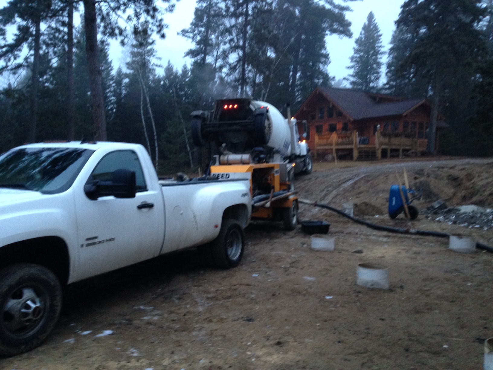

Great job, Here's what your Reed is capable of and then some, We know, we do it often ! 775' of 3" system, Customer did not want mixer on the Concrete driveway or in the yard. |

No Terry i didn't wet the hoses but the first day i did dump two buckets in the first hose and one half way through, it primed perfectly. With three inch system two buckets of quick gell (not grey bentonite) is wise. On that long pump how did you guys clean out? thats quite a job! |
| thinksnow | 12-11-2014 | reply profile send pm notify |
I do the easy way anything over 300 feet on a line job i just pick up the phone and call Ken and have him deal with it. My line pump just is not powerful enough. |
