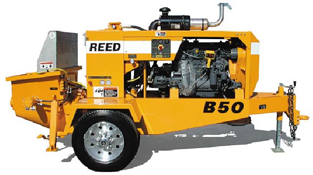

| pumpboss28 | 02-21-2009 | reply profile send pm notify |
reed b50 line pump |
| eugene | 02-21-2009 | reply profile send pm notify |
i buy fifty foot of two inch hose to make up three 16'-8" sections. so the shop[ was so eagar to fill my order they put a couple heavier ends on the hose, well no mater which end in use if its off the two inch reducer it will plug. all the rest of the hoses are fine. |
| Todd | 02-21-2009 | reply profile send pm notify |
Reed B50 is a cool pump
yea theres my girl |
