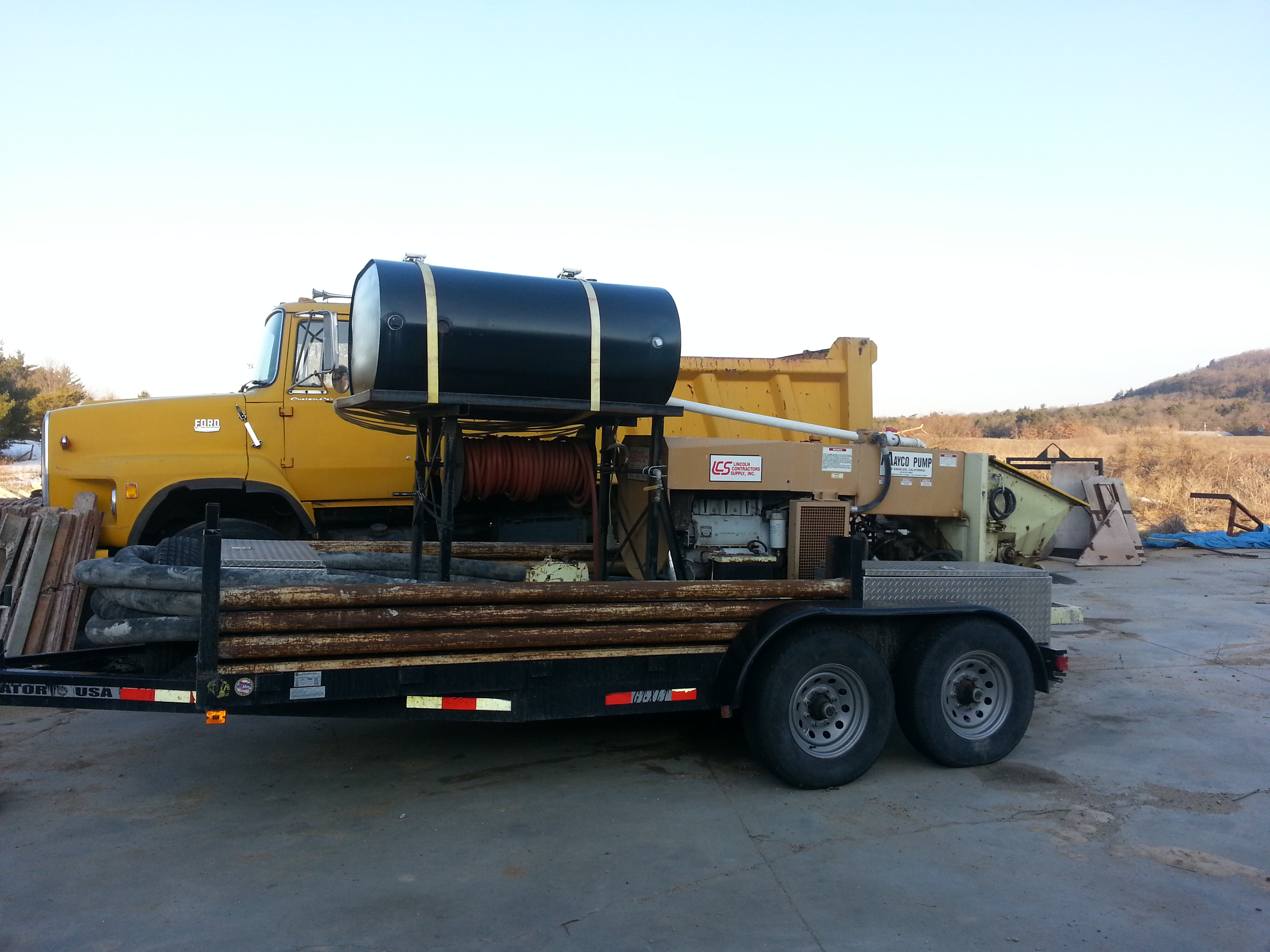

I agree with Orygun's post above. That trailer pump will give you more return of investment than a boom pump. After a while the boom guys will start referring work to you because they don't want to mess with lay-down pipe or hose.Tried to post a coupke of pics of my unit. Holds about 350' of pipe/hose,250 gallons of water with a pressure washer, Keeps the back of my truck clear for other things. Terry |

crete has a nice set up its all got to do with the application here we half inch rock so we run 2.5 inch line but you can blend 3/4 and 3/8 will pump. see how crete has his lines horse shoed. my friend does that around the front of his pump. I have a7x9 foot bed and use hose basically 17 foot or 50 divided by three. have fourteen pieces on there ad could put 3 or 4 pieces od two inch on top. I can unload a hose with one hand, pick it up and drop it to the ground and then slide the other end off with a coupler in the other hand. iam bad at posting pics but I would show you my set up. you should talk to dan martin in LA about a putz trade in 262-598-6785. later brian, in eugene |

That looks like a nice setup Crete how big is that trailer? Did you just take the axle off the original trailer pump and set the frame on the new trailer or |
| crete | 04-16-2016 | reply profile send pm notify |
It's a 16' 10k capacity axles unbolted the axles off the and used large u bolts to mount thru the bed to the trailer frame. Also have a 5.5hp wheelbarrow type compressor, it works well for system blow out/clean-up. I'm a concrete contractor that pumps on the side. also own a Telebelt [wimaterialplacing.com] |
