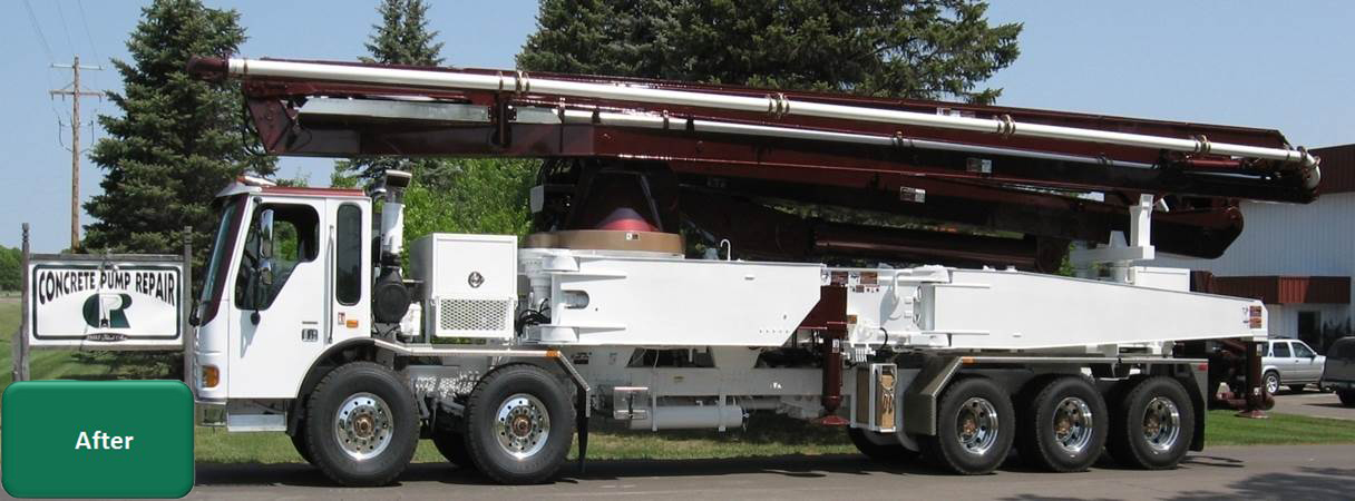

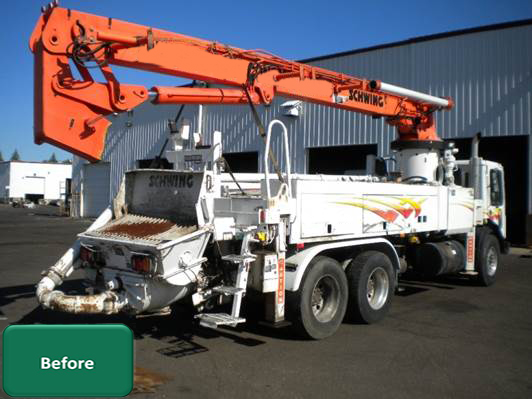

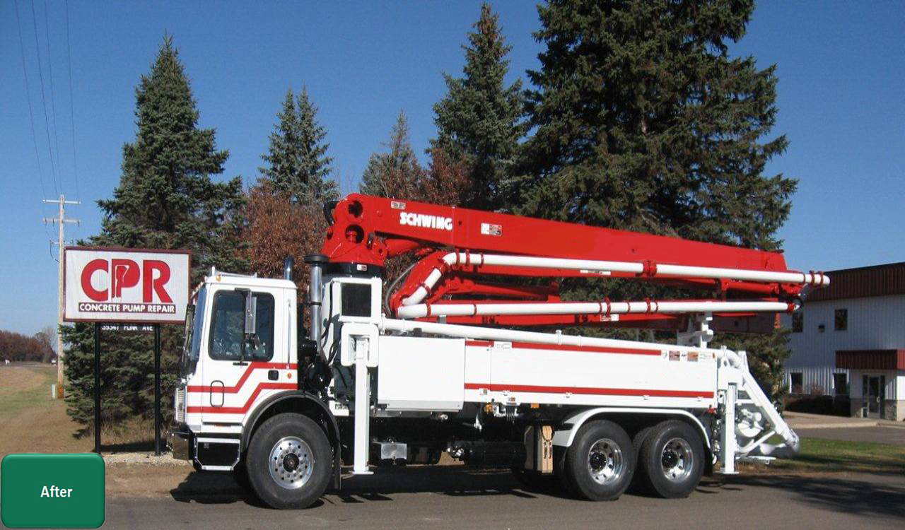

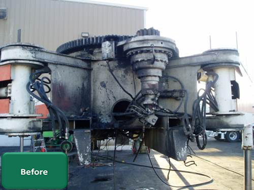

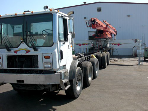

Rebuilding CPR has extended the working life of hundreds of concrete pumps. Check out some of these before and after photos. Step by Step to Rebuild Like New Step 1 – DOT truck & reposition axles or retruck w/ new unit Re-trucking Do you own a great pump that currently sits on a truck that was seen better days? CPR has re-trucked over 100 units and has the expertise to get your pump remounted and back working in less than 60 days! This process includes Step 1- Drain hydraulic oil, disconnect all wiring and hydraulics Step 2- Prep new chassis, wiring, install rebuilt transfer case and drive shafts Step 3 - Install 2nd steer axle (Mack spring style) Step 4 - Mount unit on new chassis, weld and huck-bolt onto frame Step 5 - New suction hoses on all hydraulic pumps Step 6 - Hook up all wiring, new main power from batteries to hot box Step 7 - Hook up all hydraulic lines and hoses Step 8 - Clean hydraulic tank, fill with new HLP46 hydraulic oil, replace main and boom filters Step 9 - Run unit, check pressures and test for leaks
