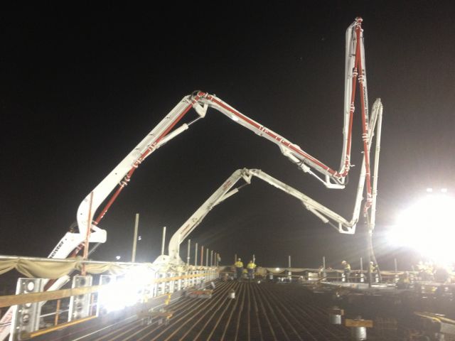

I run a new light weight putz 47 roll z when they got delivered I asked the question if its better to lock the stages together or leave them loose to allow movement while pumping. I was told by the rep to lock the stages together what's the feeling out there about restricting boom movement |

Z or A frame will work, most customers tell me this type of boom will run smoother in the pattern you display in the pics. What is in the pictures is ok, I am concerned about the Term “Locked Together” it is not good to have the boom arms so tight that they are hitting each other during pumping, close like in the pics is ok but tight is not good. |

When we first got them we had a putz rep come to answer any questions that was one that I asked |

I close 3rd 4 th&5th together all the time to get back to the pump doesn't do no damage and mine is nearly 6 years old no cracks do it creamy hows my alloy cleaner going is she pritty again
