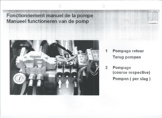

had the same problem with an old putzmeister some 20 years ago. at that time the exchanger was broken. the old putzmeister had an exchanger button in the watertank of the cilinders and the little plate which had to click on the button was bended. so it was allways the same cilinder that went up and down in the lines. these days the exchanger is inside the command-block maybe one of the valves is dirty and doesn't command the exchange? maybe you schould try to make the pump work manualy to see if the exchanger works? in the picture you can see on arrow 1 how to suck back and arrows 2 to pump. |
| mrpumpy | 04-03-2012 | reply profile send pm notify |
i hope you can do something with it |

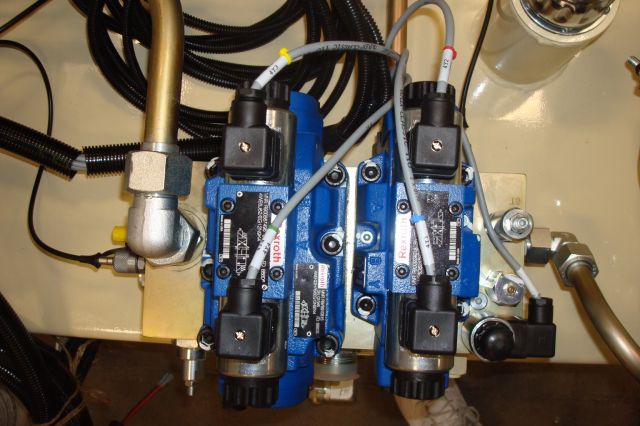

Just a quick follow up. This customer has been working with the dealer and myself, the problem seams to have been the K238.1 relay, the issue was the drive cylinders would continue to stroke and the s-tube would stop on one side and not shift electricaly. This is a Tomkatt style system with a cycle valve for the Drive cylinders and the s-tube , it has 2 , K238 relays one for eack valve, and no M8 pressure reading, He did once blow a fuse so he is checking the coils for resistance with heat. So far so good. Thanks for the input thought you would like to hear the result so far. |
| Travelteck | 04-06-2012 | reply profile send pm notify |
These are similar to the valves he has. |
