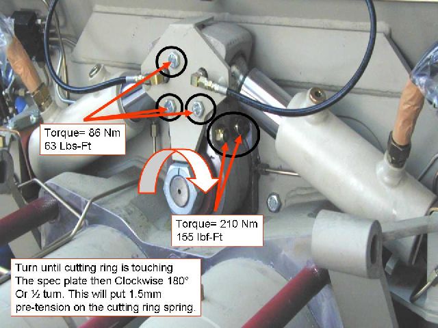

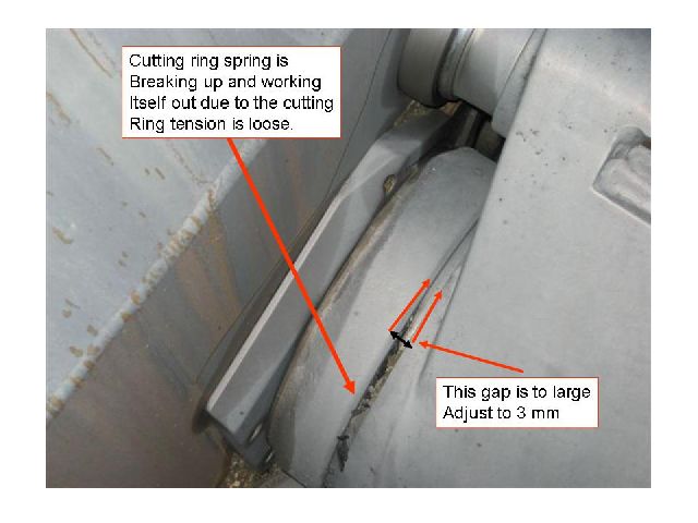

Mr stink 21 asked a question about cutting ring setting I am assuming it is on a Putz. . There has been a lot of misconception through the years about tightening the cutting ring on a putz. To much and the tube will bind when pumping concrete, to loose and grout will get behind and “jack” the cutting ring against the spectacle plate and bind again or leak grout causing pumping issues due to loss of grout. In the past we recommended the s-tube be tightened to a gap of 3mm (this is the gap between the cutting ring and the s-tube see picture) using the 65 mm tension nut on the back of the hopper. To obtain a more consistent and uniform tension on the cutting ring, the standard tensioning procedure has been modified to the following. This is assuming that all is clean flat and in good condition including the cutting ring spring. Step 1 tighten the hex nut up until the cutting ring is touching the spectacle plate but not compressing the spring, do not apply pressure to the cutting ring spring- Just tighten till the cutting ring is touching the spectacle plate solidly. This is your starting point. Step 2 turn the Hex nut 180° or ½ turn clockwise, the cut on the threads will apply 1.5mm of pre tension on the cutting ring spring, you might need to turn the nut a little to line up the lock plate. Step 3 Install and torque the pinch bolts. Torque for the pinch bolts is 210 Nm or 155 Ft Lbs. It is vital to torque these pinch bolts, failure to do so will result in premature wear of the s-tube splines. Step 4 reinstall the lock plate and torque the bolts to 86 Nm or 63 Ft Lbs. Test shift the unit to ensure the S-tube is shifting smooth and even side to side. When done install the safety cover over the moving parts.
