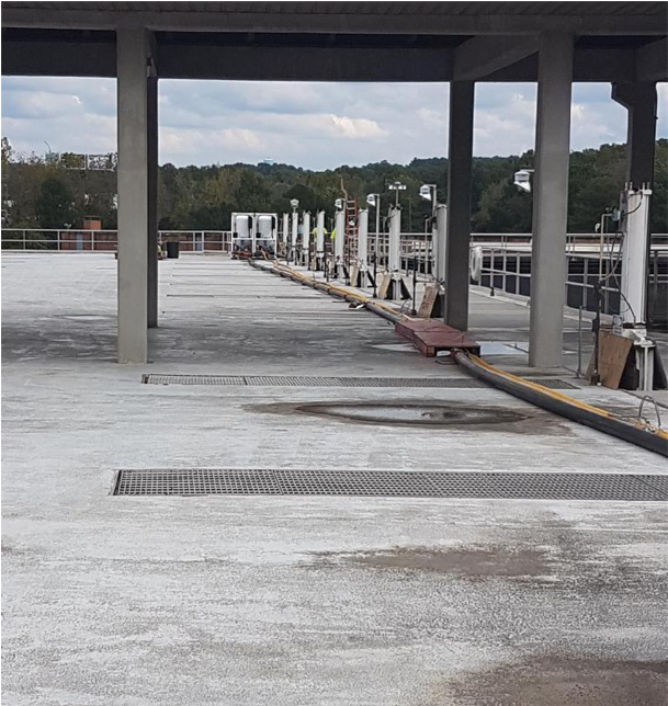

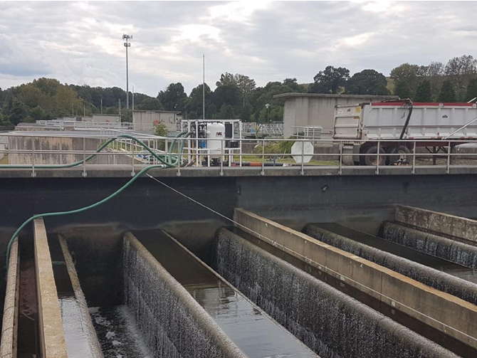

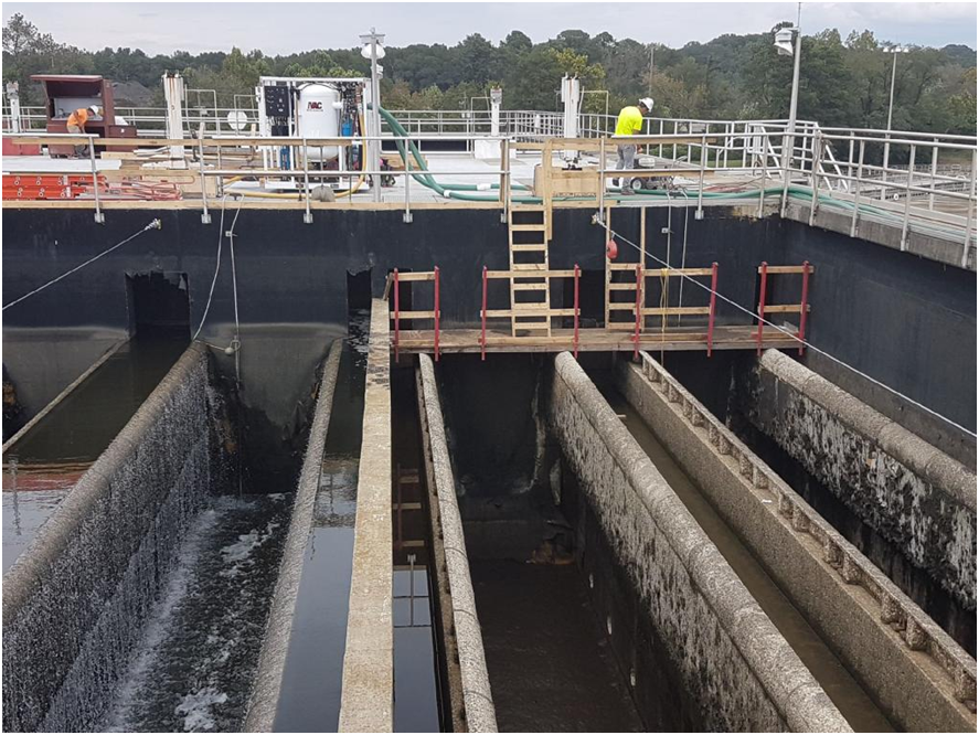

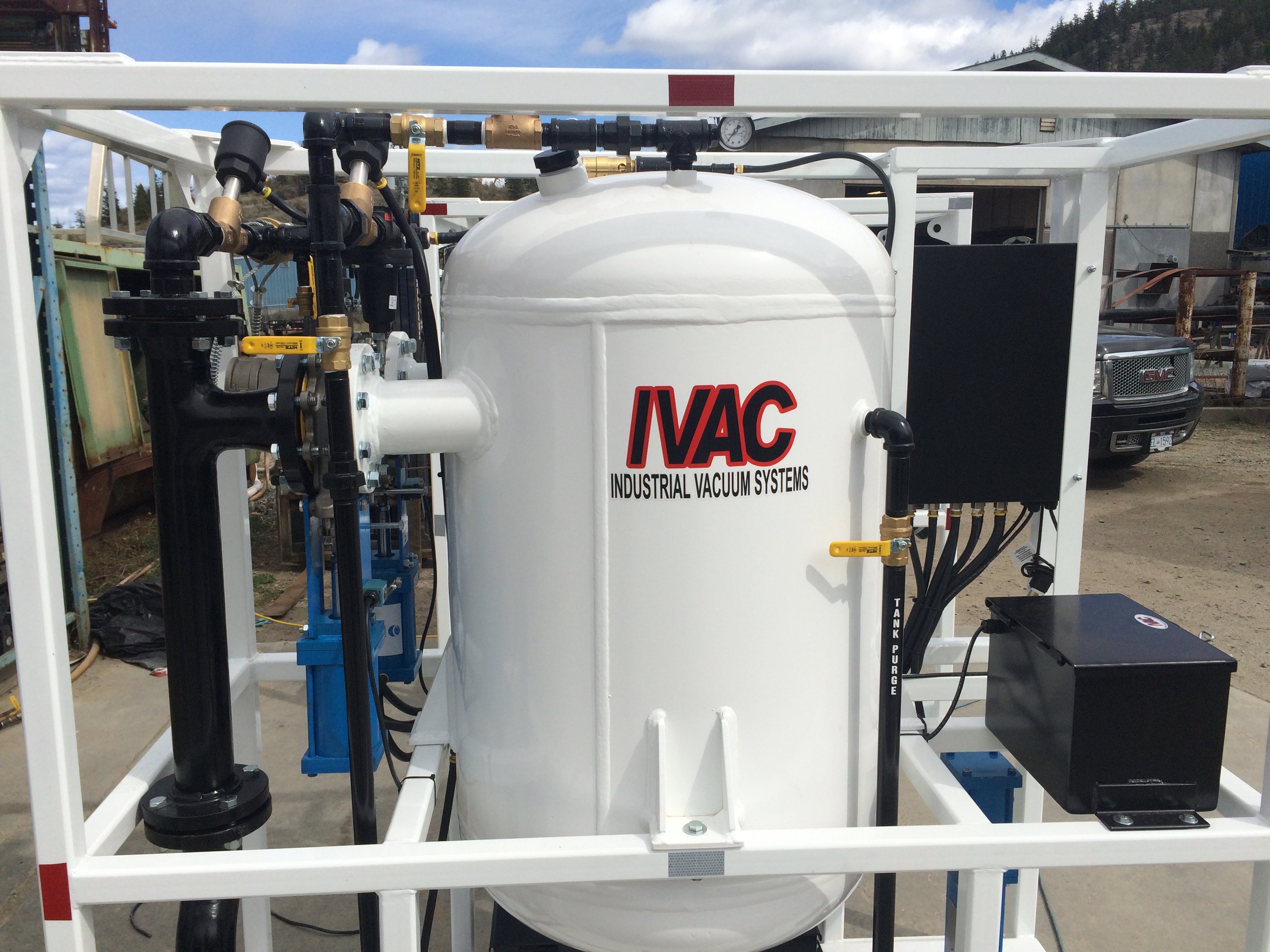

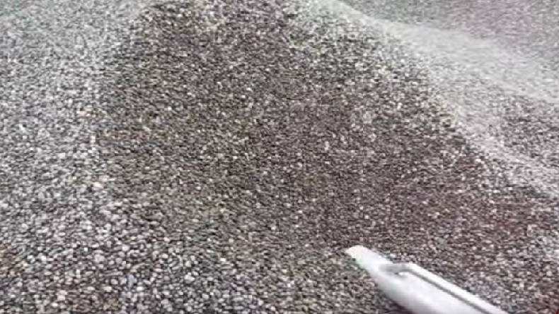

With an IVAC vacuum/delivery unit our customers change out water treatment plants sand filter media. No water is required since IVAC Vacs can pump wet or dry materials. The enclosed video shows an IVAC pumping gravel out of a loader bucket. An IVAC Vacuum unit vacuums up your desired materials and then discharges the materials long distances- even kilometers away! The attached pictures show the filters that the filter media is removed and replaced with one of our air powered vacuum/delivery units. Contact Us Today for sales and/or rentals of sand and gravel pumping units. 1-888-502-2468 - 1-604-628-3367 email sales@ivacvacuum.com |
