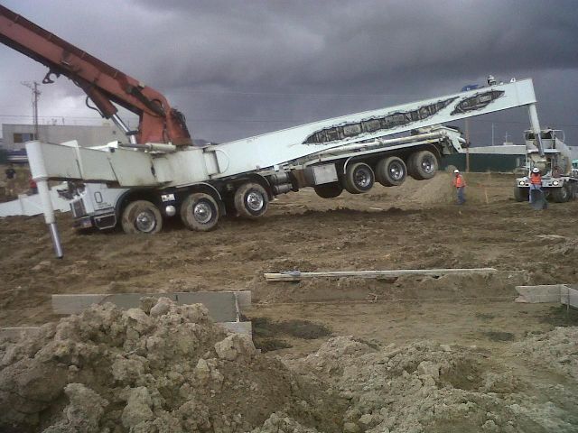

wow where was this at what size and looks like bad soil |

Wow thats a good looking pump, It would look better on all four |

it is a concord 60m Thats all I know |
| orangeboom4u | 03-05-2011 | reply profile send pm notify |
Those 60m concords are heavy pumps. 129,000. A lot of dunnage is required for them. I do believe it is a 2005 or later model. Hence the front outrigger folds over the back and the outrigger controls are on the rear outrigger. |
| 16 CELL | 03-05-2011 | reply profile send pm notify |
I believe it's actually a 65M Concord/KCP as it has a three stage front outrigger, whereas the 60M units only have a two stage... someone please correct me if I am mistaken... more importantly, I hope no one was injured in this incident. |
| orangeboom4u | 03-06-2011 | reply profile send pm notify |
I think they changed that in 2004 I could be wrong. But the 65m also has a drop axel. Dont see one here. I have been wrong before LOL! |
| pink panther | 03-07-2011 | reply profile send pm notify |
I am going to guess a 65 because the front outrigger span is pretty close to the rear span. That is the only conclusion I come up with. A 60M is about 36' across and the 65M is 44' across. Like I said, just my guess. |
| TooTall | 03-07-2011 | reply profile send pm notify |
The earlier model 65m didn't have a drop axle and always had 3 stage front outriggers. They've changed quite a bit since then. I'm pretty sure it's the very same 65m in this picture... |

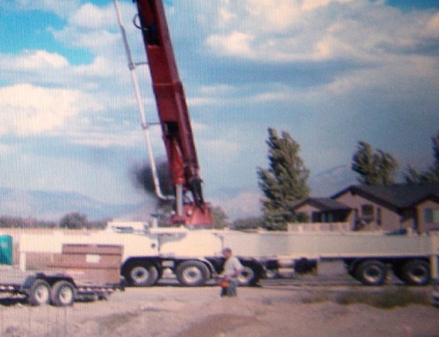

The very first 65m did have a drop axel I do know this for a fact. Here is a pic of it. Ainsworth helped design some of this pump. I have seen this pump as it rolled in as the very first 65m made. |
| orangeboom4u | 03-15-2011 | reply profile send pm notify |
but it could be a 65m made after this one ordered w/o the drop axel or it could be the newer 60m inwhich they redisgned the outriggers. |

I run a 65 and thats a 65m kcp looks like they should of used more cribing |
