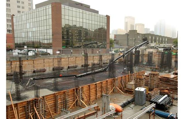

| typesdubs | 09-15-2010 | reply profile send pm notify | ||||
I'm going to guess that long black thing near the tip might be a few hoses he was picking up or pulling back, just a guess, glad no one was hurt and would love to know how it really happened. |
| Drew AUS | 09-15-2010 | reply profile send pm notify | ||||
I agree looks like he might have been trying to empty the hoses with the boom , but you never know .... |

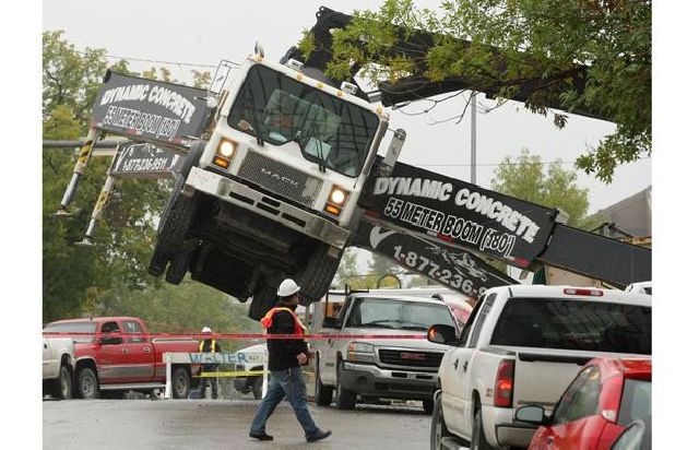

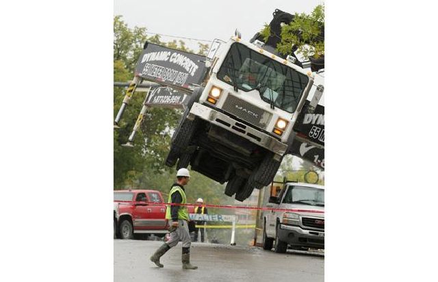

| 52putz | 09-15-2010 | reply profile send pm notify | ||||
I know in the Concord I ran, when booming over the side, you really needed to have opposite side outriggers fully extended as a counterbalance. Otherwise it would bounce around and the feet would walk around on the pads. I also requested the outriggers full with diesel or water(depending on the outrigger) for weight. That looks like part of the problem... |
| Munir | 09-15-2010 | reply profile send pm notify | ||||
Yes 52putz. You are right my guess is same thing because the job side outriggers are looking in good position but I think other side outrigger was totally empty. (Usually 55m. pump heave operator side outrigger is water and other side is diesel) The problem is some company changing the operator every day to different pump and some operator do not care about extra diesel in out rigger they fill only in tank when they last day park the pump in shop. And next day when other operators take the same pump usually he heave short time to reach his job site he also doesn’t care about that because some company don’t want to call the operator little bit early. It’s also depending on the management how much they giving the attention like these things |
| ice | 09-15-2010 | reply profile send pm notify | ||||

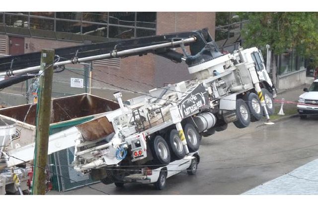

No reason for that pump to turn over unless that back outrigger was shortrigged. One foot would've been enough. |
| BJN | 09-15-2010 | reply profile send pm notify | ||||
This is an excellent comment and right on the money I think. You see short setting on the oposite side too often and operators don't realize the importance of that cantilevered weight |
I understand. Just using my experience. Just look at it this way; He has the boom fully extended with the tip section up a bit (so he was probably trying to stop the mud from dripping out the hose), and he was lifting three? 4" hoses. My guess is: He had everything in the air (hoses, boom) and either swung or dipped the boom too quickly. The torque when the boom stopped was too much for the footprint and the weight of everything full of mud took it over. Just a guess. As far as I can tell, he did almost everything right so he's a safe operator...just had bad luck. Schwing and Putz do a fabulous job engineering these machines but I'm sure they test under more optimal conditions. |

It doesn't look like there is much hose on there at all but it does look like he was lifting the main when it happened. In the pictures you can see the cylinder for the main section is not bottomed out and actually up some. In my opinion it would have been bottomed out for maximum reach into the pit. Wouldn't being stretched out and booming below the truck like that create a greater amount of "torque" on the unit since you are booming so far below the center of gravity? Those big pumps can be a b*%&h to get set up sturdy when you are stretching them out. Some days it seems like you never get it right. In my opinion its just like another man already said. He got a little wild with the boom and it went past its balance point. I'm willing to bet the whole time he was pumping the opposite outriggers were flopping around or in the air. It will daefinitely make me think the next time I stretch our 61 out and the outriggers start floating. All it takes is that one surge or getting a little wild with the sticks and you have pictures like this. Just my opinion fellas. Could be right could be wrong. |
| drummerboy | 09-15-2010 | reply profile send pm notify | ||||
Having been involved in the manufacturing of concrete pumps I do know that this brand engineers their pumps stability with the outrigger as a counterbalnce. In fact most companies use this procedure because it is a factor in which the whole machine can have a slight wieght reduction. It is often not an issue except when the bounderies are pushed beyond the safety margins. not sure what happened here but there is a thousand words in just one picture on the post, pretty easy to read. |
| baddogpumping | 09-16-2010 | reply profile send pm notify | ||||
Funnyboom has the right idea when it comes to booming below grade and stretched all the way out like this pump. I think almost everyone here has had at least one pucker factor of 10 and said to then self "crap that was lucky" unfortunately this wasn't one of those time. There has been a time or to where we had to anchor down the off side with either cables to counter weights or a 980 Cat loader. As for that p/u truck in between the outriggers which was probably an inspector's truck and I will almost guaranty he will never park there again. |

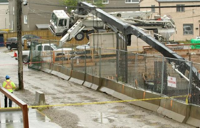

What would be interesting is the pictures getting the pump back on solid footing. |
| SUPERDOFFER | 09-16-2010 | reply profile send pm notify | ||||
There is not much trouble setting that pump on his feet. Setup a small crane on the of working side for control and bolt of the pipes one by one. A boom whit out pipes isn’t heavy he comes back on his feet real smooth. |
| pumpjockey | 09-16-2010 | reply profile send pm notify | ||||
Pop the clamp on the reducer at the tip - problem solved, except for the immediate crash that ensues. But seriously, 2 cranes, one to lift at the first section, one to 'catch' and set the pump down gently. Once the cranes are supporting load, then pop the clamp. When it's back down to terra firma, clean the hopper on site, then water wash the boom, fold up and drive to Vancouver for the neccessary inspection. |

Facts 1) The outriggers were fully expended, 2 )The pump can be short rigged on the none working side, 3 )sections 4&5 were lifted some while the main was lifted to drain 1 or 2 hoses, 4) The pump tipped over slowly and no one was hurt 5) No real operator error (Not a new operator) 6) Alliance is investigating , no real explanation scary?!?!? |
| pineos pumpin | 09-16-2010 | reply profile send pm notify | ||||
i know the operator personally and he takes his time settin his pumps up. the outriggers on the work side of the pump were fully extended. the only outriggers the were short rigged was on the passenger side. |

Ill go with ice on his idea of the rear outrigger. And the dumpster next to it. I ran the 55m 260 putz for years never had a problem like that. The out riggers don[t even have to be out on the other side .They are not a counter balance.BUT THEN AGAINyou put the wrong gauge pipe on the boom it;s a differant ballgame. Ok now that is three accidents with large booms.The one in florida telliscopic boom.The schwing with the boom link on the main section.So Todd why don;t you put the outcome of the accidents up? And keep it there next to one of the flames like the pumper test. |
| Blaine Torgerson | 09-17-2010 | reply profile send pm notify | ||||
Everyone seems to have a theory. How 'bout this one...
The pictures don't show where the outriggers were placed. You can clearly see the ground is wet like it's been raining. Maybe he sunk into the ground enough to put the pump past it's tipping point. Similar accident happened to one of my operators down here in San Diego.
Set up on pavement but there's no way to tell if the ground is undermined 8' below from water erosion unless you have a big red S on your chest and x-ray vision.

The pump was short rigged END OF STORY. 55M alliance pumps are to never be short rigged period. I run the exact pump here in saskatchewan and would never have done that. |
| pineos pumpin | 09-17-2010 | reply profile send pm notify | ||||
95% of the time in downtown calgary theree is only enough room for your outriggers on one side. maybe this will open the contractors eyes and will give the the guys more room to set up. |

Out of curiosity where was the operator? Was he down in the hole at the end of the boom or on the side of the hole looking down, or on his pump? The question is did the pump go over so quickly that it could not be prevented at all, or if a trained operator was standing on the back of the pump could he have sensed and alerted the boom operator that something was amiss, shut down the pour and solved the problem before it reached the point of no return? |

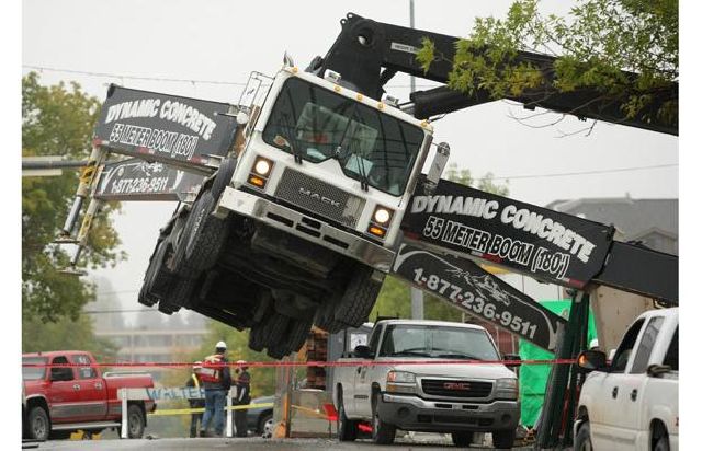

First off, just to clear the air the “Alliance” 55 meter boom pumps mounted on the MR Mack tridem /tridem trucks that we have in our fleet (we currently have four) are very stable when short rigged on the opposite side of the truck that the boom work is to be performed on. What makes these units unstable is if the down cylinder on the short side outriggers are not checked and adjusted downward throughout the pour to prevent any space from the bottom of the foot of the outrigger and the outrigger pad. Providing the short side outrigger is snugged up these units have been very stable and in our area short rigging is common and the only method to access projects. The reason this pump tipped over was because the operator used the boom to pull back two hoses full of concrete by lifting the fifth section of the boom upward with the rest of the boom flat out and in a negative position (slab was below grade elevation). The extra weight and extra force this applied to the boom was well in excess of its design and capacity and as all experienced boom operators would know this cannot be done anywhere anytime without serious consequences . This was the sixth time we had pumped concrete in the same relative position using 55m booms on this site, with the same outrigger and boom configuration without incident. The same pump and operator had also completed a previous large slab pour without incident. The best news of this incident is nobody was injured, and Dynamic is feeling very, very fortunate that we did not lose any of our Dynamic placers and finishers who were working under that boom for Dynamic as they are all like family here. The pump sustained very little damage and Thursday passed an engineer’s structural inspection for safe continued operation. Dynamic Concrete Pumping Inc. www.dcpu1.com |

Just goes to show you "muddy" don't do things the pump should not be doing just to get the job done! |

Here is how we lifted it back onto its feet without any issues, 125ton crane with a sling around #1 section (main) and a wrecker with his sling around front short rigged outrigger to prevent it from coming back to quickly. Crane lifted main and the wrecker lowered his sling keeping the sling with minimal tension. DCPU
| Vasa | 09-18-2010 | reply profile send pm notify | ||||
dcpu1 do you remember what the crane-scale showed ? With or without mud in the pipe ?
A nice NRC rotator who hold the pump when the crane lifted your pump !
Can we have some guess on the weight in the crane !
| dcpu1 | 09-18-2010 | reply profile send pm notify | ||||
I seem to think it hit 18,000lbs at peak lift |

When the boom is fully extended, and the pipes full of standardweight mud, the center of gravity or center of mass of the entire machine is hovering mere inches away from the envelope created by the outriggers. The footprint on a fully rigged pump is a clearly defined square/rectangular shape, while the center of gravity is more likely egg-shapped if viewed from above, owing to the weight distribution of the chassis and the forward position of the turret on the chasis. The greatest distance between the outrigger envelope and the C of G is likely when the boom is directly over an outrigger, ironically, this also is when the force on the outrigger pad is the greatest, you can't win for losing. The additional weight of system and mud at the boom tip, plus the fact that it was below grade and lifting it caused the radius (however slightly) to increase, imposing even more force, moving the C of G ever-so slightly further, and if a clamp happened to catch - even momentarily - on rebar. There you have it, the Perfect Storm for a big boom. The engineers ain't kidding when they give the maximum weight to be put on the tip, it's not a suggestion or guideline, it's a real number. Again, this is a great discussion point for certification. How many boom pump operators finished their high school Physics? This is a complicated concept, when looked at in depth. |

What is Alliance's maximum tip weight on the 55m? Add another 100 lb (45kg) to that and you're playing with fire. Being short-rigged on the off-side would definitely not help the situation in the case of overloading the tip and upsetting the C of G. We're talking very small differences here, but it may very well be 'the straw that broke the camel's back.' |

I have a totally different take on this accident, I will not blame the operator, or the company. I blame the contractor for not allowing enough room to properly set up the boom. There is not a road, street, avenue, or municipality in North America where you cannot get a permit to close a road. Contractors are responsible for making sure the pump, or crane has enough space to do thier job safely. This is a prime example of a contractor being too cheap to properly allow the job to be completed safely. Sure it will cost the company a few dollars for a permit, but is it worth risking an accident of this magnitude in order to save a few dollars? If you can get permits to close roads in New York City like I have done several times, then I can assure you , you can get one on a side street in Canada. Just my take on the subject. We all keep preaching safety, but when it comes to spending a few dollars to do a job properly, then safety goes right out the window. Hopefully the operator is ok, and go back to work, lesson learned. |

| pumpjockey | 09-21-2010 | reply profile send pm notify | ||||
donnie: http://www.youtube.com/watch?v=0NCFWRwz8TM dcpu1 describes it above, and Todd has created a second thread. Here's the text of dcpu1's post: Here is how we lifted it back onto its feet without any issues, 125ton crane with a sling around #1 section (main) and a wrecker with his sling around front short rigged outrigger to prevent it from coming back to quickly. Crane lifted main and the wrecker lowered his sling keeping the sling with minimal tension. DCPU |
