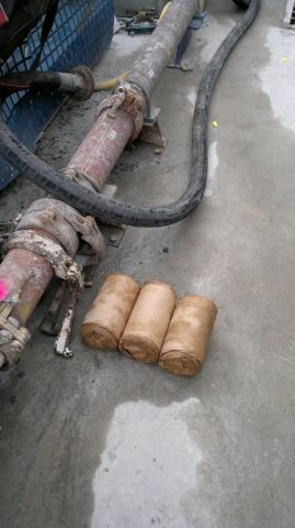

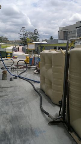

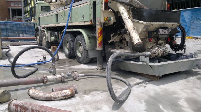

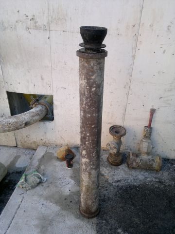

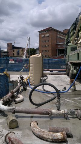

| jonno | 01-10-2013 | reply profile send pm notify |
Pretty sure I have posted this link before, but hear it is again. http://www.youtube.com/watch?v=Hz5Z0YULdrk + some pics because I cannot type 1000 words;-) |
