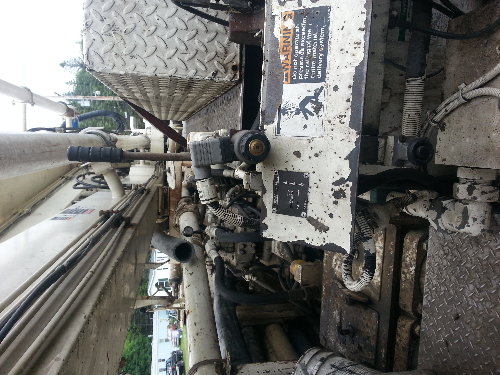

| Mister_Perkins | 06-02-2013 | reply profile send pm notify |
on the 42 there isn't an electrical plug on the brain near the mechanical gauge but all the hydraulics run to the rear of the truck. attached is a picture. under the pump forward and reverse there is a plug that looks like its hooked right at the bottom of the pump block. could that perhaps be the transducer plug your speaking of? |
below the forward reverse switch is also the e stop manifold. |

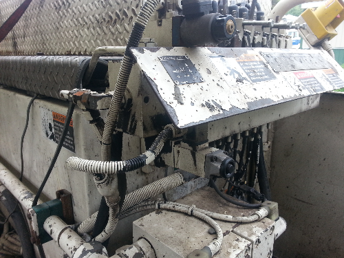

another view. hopefully this is facing the correct directiob |
I found the transducer but I think I have bigger problems than that. I don't have temp, rpm, or pressure on remote. on back panel temp works but rpm doesn't. |
