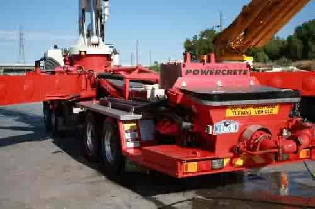

| eugen_syd | 08-06-2009 | comment profile send pm notify |

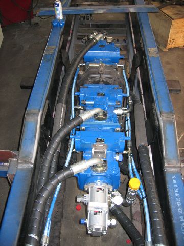

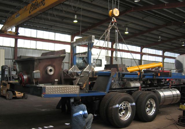

Hey People, Look at what POWERCRETE is curently building in Australia. They build their own pumping module with A4VG180 triple pump unit feeding 6" diffos driving 10" concrete cylinders all controlled with REXROTH Micro Controller. A 48M 5Stage ANTONELLI boom will be fitted on this pump. Would you like to own such concrete pump? EUGEN |
| eugen_syd | 08-06-2009 | reply profile send pm notify |
and another picture! |

| 52putz | 08-06-2009 | reply profile send pm notify |
What is that between the front and second pump cell? Some kind of torque converter? |
Ohhhh, must be some american humor I can't get. I thought you guys like....BIG...and FAST. However I forgot to mention that has 8ft stroke and has been provided to select 1 hydraulic pump, 2 hydraulic pumps or 3 hydraulic pumps as needed. You guys better get the concrete on the way before you leave the yard! However you guys enjoy there 60+M boom pumps!
Eugen |
That is the Power Take Off (PTO). We use split cardan shaft for engaging the hydraulic pumps.
Eugen |

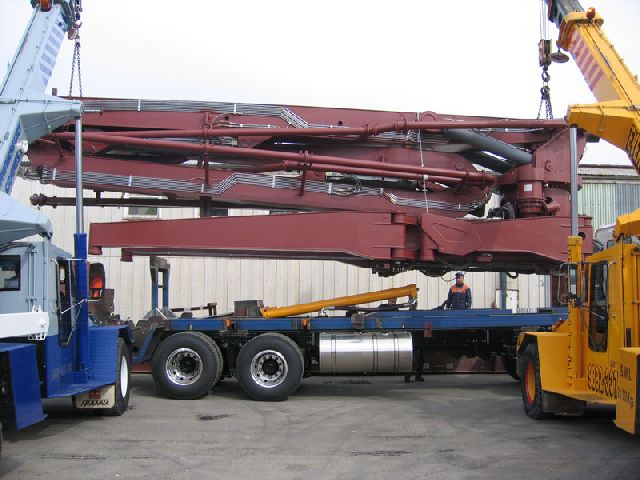

| 52putz | 08-10-2009 | reply profile send pm notify |
Wow. That whole thing they are dropping onto the chassis is the catwalk attached to and around the pump?! Awesome. I figured that was just a jig to mount the pump and hopper. nice. |

| eugen_syd | 08-11-2009 | reply profile send pm notify |

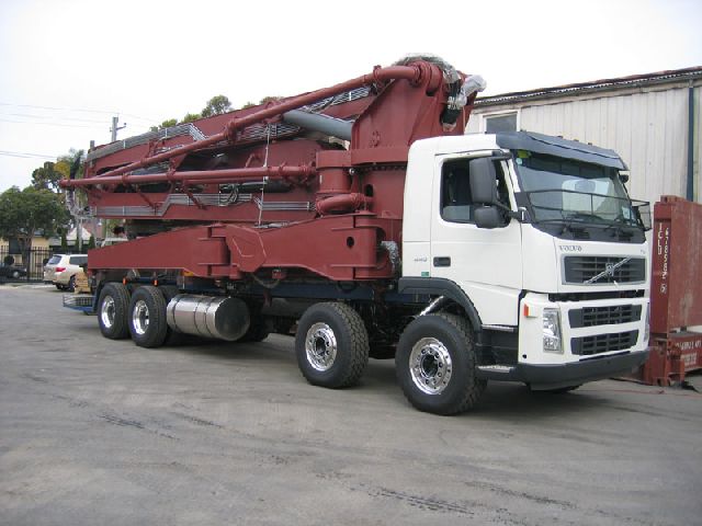

Hi people, Here some more pictures on the job progress. Finaly we have a boom on! |
And now looks more complete. |

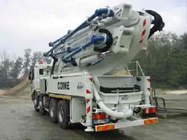

| TooTall | 08-12-2009 | reply profile send pm notify |

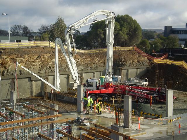

Had to borrow your pic Drew, Thanks mate! Doesn't Coime use Antionelli booms aslo? They look similar and have that Italian contour like a Cifa. |
| eugen_syd | 08-12-2009 | reply profile send pm notify |
Hi TooTall, Don't worry about dragass up ramps (hills) because truck has airbag system which is dumped for pumping to bring the hopper down. When driving will revert back to ride height or you can jack up even further if required. Eugen |

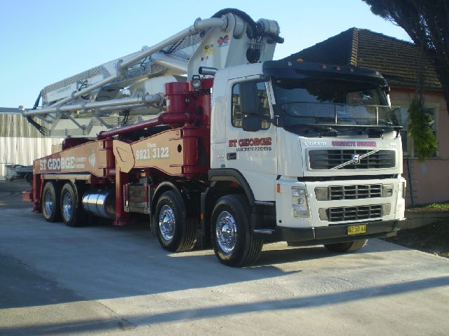

| pumpaholik | 08-24-2009 | reply profile send pm notify |
howz it going eugen love ur photos and love ur pumps iz the powercrete monster gona keep up with the ST GEORGE'S CONCRETE MUNCHER. |

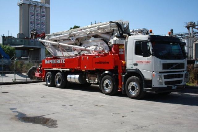

another 1 of our powercrete pumps |
| eugen_syd | 08-31-2009 | reply profile send pm notify |
Hey Mate,
Great pics and very nice kept pump. Sometimes have to remind myself that yoru pump goes to work every day. I would like to say that you kept that pump prestine. For everybody first pump is a 48M Boom 5 Stages and second is a 46M 6 stages (COIME BOOM).
Well this pump will be a touch more powerful. We use 3 hydraulic pumps same like the 2 in your pump. 6" hydraulics comparing with 5" yours and 10" del cylinders comparing with 9" your pump. So we will use a first 500HP VOLVO EURO5 (first to be in Australia). So, is a little bit of a fist of everything there that is why we got so excited!
Will be a ...."TOOL".
