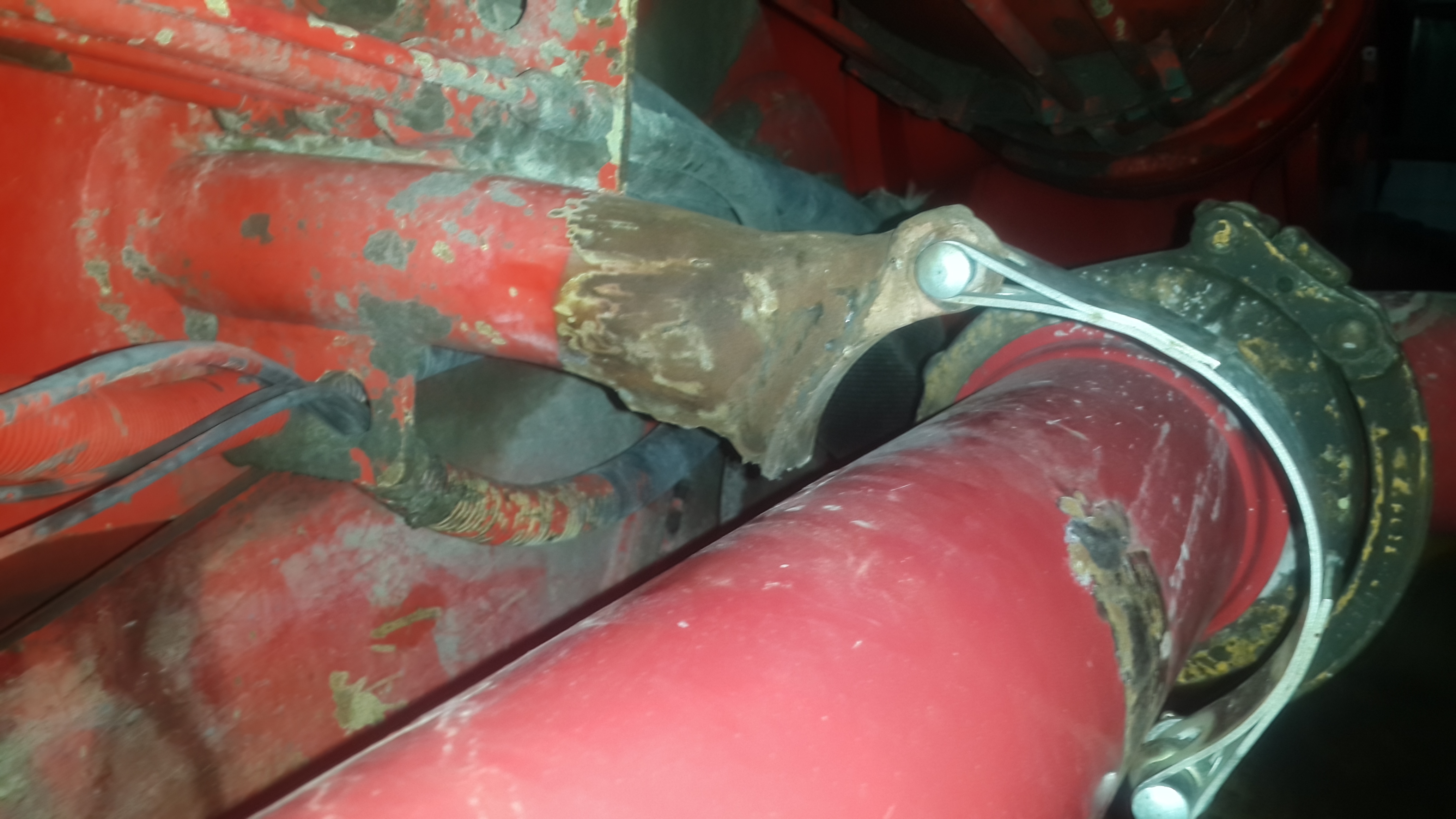

in my experience , better put a seasoned operator on that pump, that kind of pressure and that much volume you can tear some stuff up , be very aware of keeping a eye on the dog bones , have had issues with cracking in my 40 meter , and better keep a eye on pipe supports and clamps , I have had issues with swivel clamps the sides busting out. |

agreed Beast. hence the re-enfored pipe brackets. Respect is needed for this beast. Yes, inspecting the dog bones should be part of your weekly with 11s, espeacially if running lots of systeme off the boom. only seen one bone break, it was an 11 and took years but it broke. |

the two bolt schwing style swivels clamps are the best IMO |

I had a 20 cell putz , the dog bones bent and the diff cylinder rod snapped , causing a lot of damage , over 40k in repairs , and deck pipe brackets are a constant maintenace issue , what I have experienced with Concord pumps , the dog bones ( I have been through 3 sets) and the pump is a 2012 , keep your eyes on them and keep them clean where you can see cracking. and clamps , need to be checked weekly , tip swivel daily and keep that safety strapped attached. |

i think schwing boom pipes brackets is the best .we have here too many putzmiester pumps and we have too much problems in pipes clamps and most of them because of the people who are replacing the pipes. |
