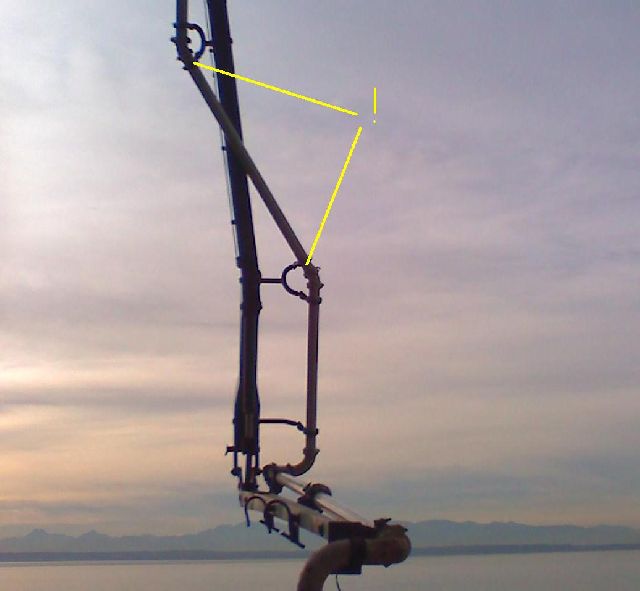

| TooTall | 01-24-2010 | reply profile send pm notify |
I agree it depends on the style and brand of pipe. There are some problem areas that tend to wear faster than the rest of the system on that kind of boom. I've had problems in the past with the compression side (bottom) of the pass over pipe on the 3rd. |
I've seen both ends of that pipe blow more than any any others on that kind of boom. The worst part is it usually blows right where the bracket holds the pipe making it really hard to patch! |
