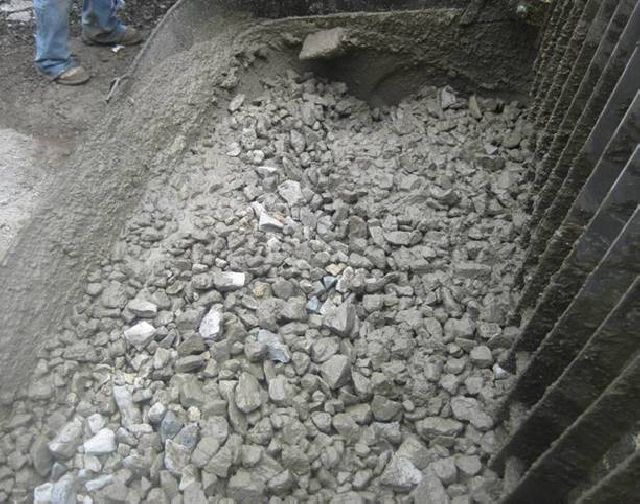

i think this photo is mine i posted it before .this is always happen when slump is too high the mortar is going and the aggrigate will stay in the packet. |

The picture of the hopper full of rocks is some of the nastiest crap I have ever seen. |

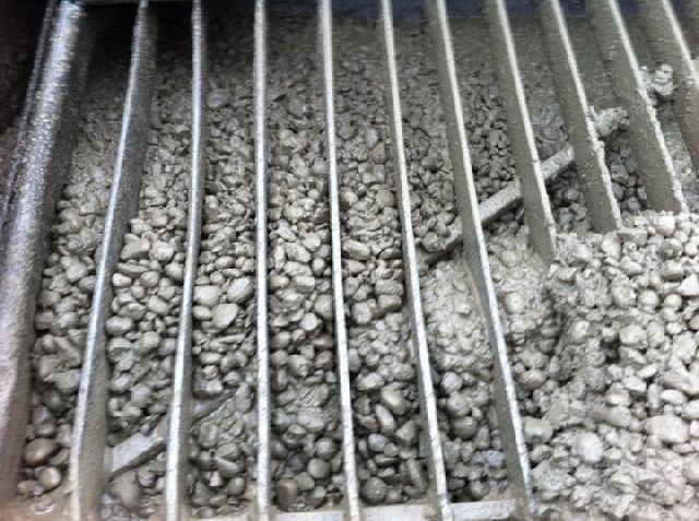

79xlch, here's another one for you. Gotta love huge dry agg, they pump so well. |

Someone needs a TB-130 bad. |

shady: large agg will never improve pumpability, only increase the potential for plugs. On the other hand, too much sand (or manufactured sand) can be a negative and cause plugs too. A good gradation that fills in the gaps in each size is best if you can get it. If interested, ACI has two publications that discuss gradation: ACI 302 for sand and ACI 304.2 for agg gradation for pumping. http://www.concrete.org Other rules of thumb: Water/cementitious (W/C) ratio greater than .30 (.40 to .60 preferred) Mortar volume >45% Powders >400 lbs/cu yd (if >700 lbs/yd watch for low W/C) |
