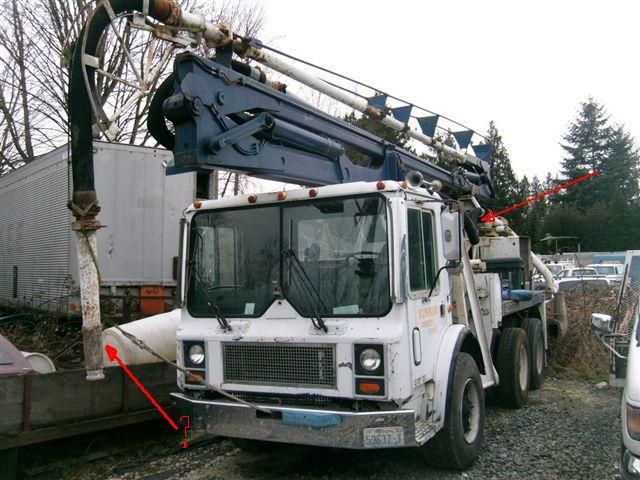

Lets not forget that a long time ago almost every boom had a five inch tip hose instead of elbows with reducers on the end of it. It's still totally Stupid and dangerous!!! I can see it happening on a rig like the one shown below just because the dumbass was to lazy to put his whip on... |

TT,I could have sworn those came from the factory 4" booms. |
