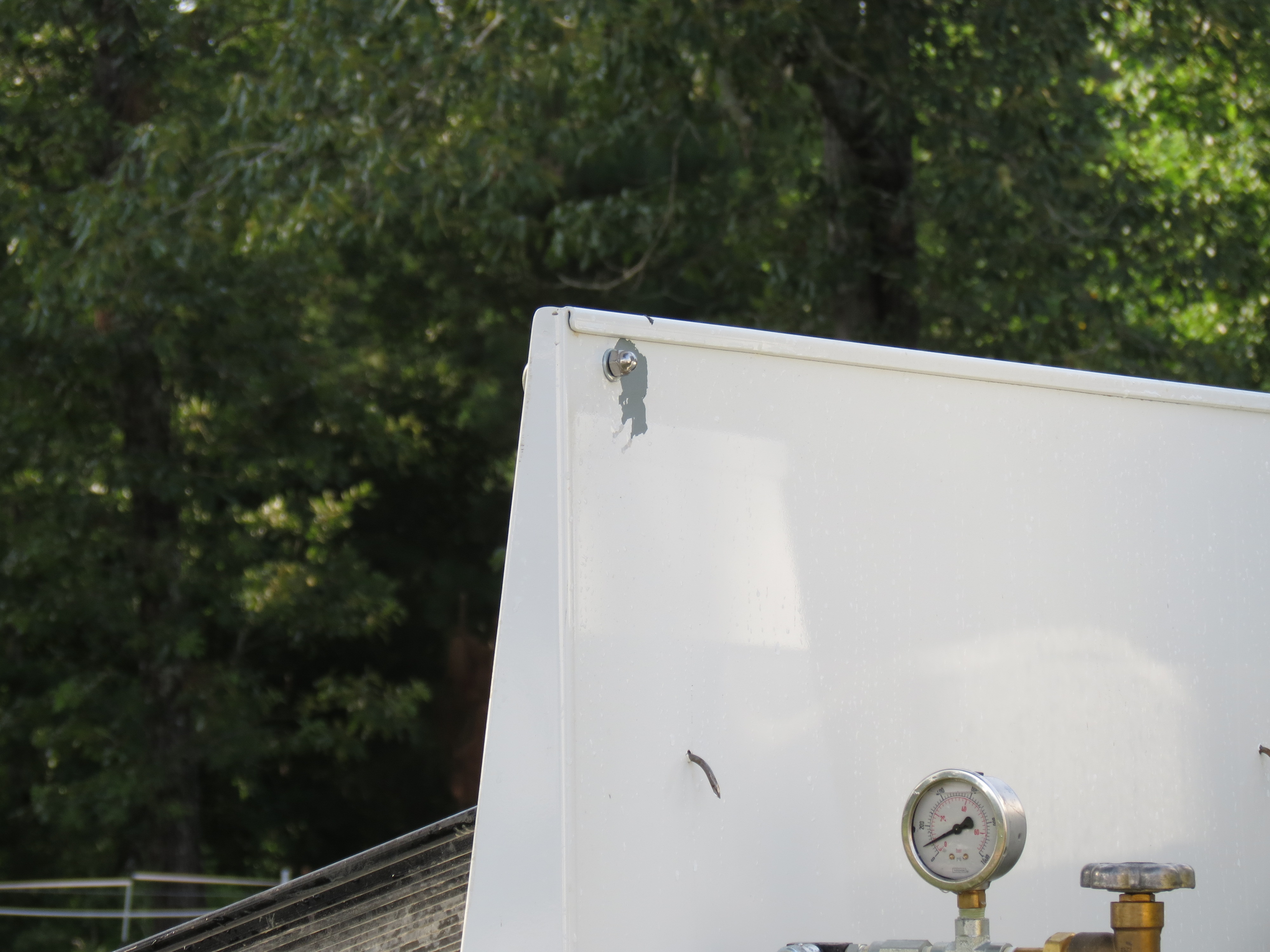

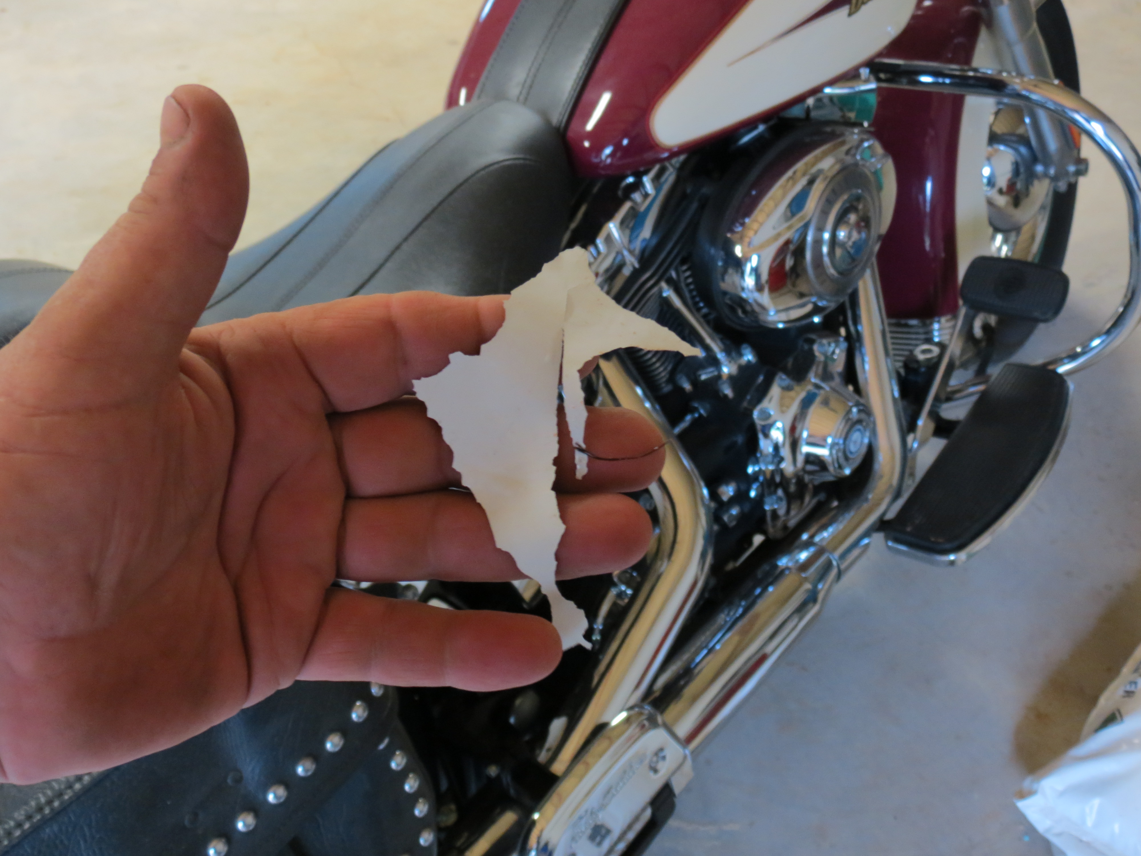

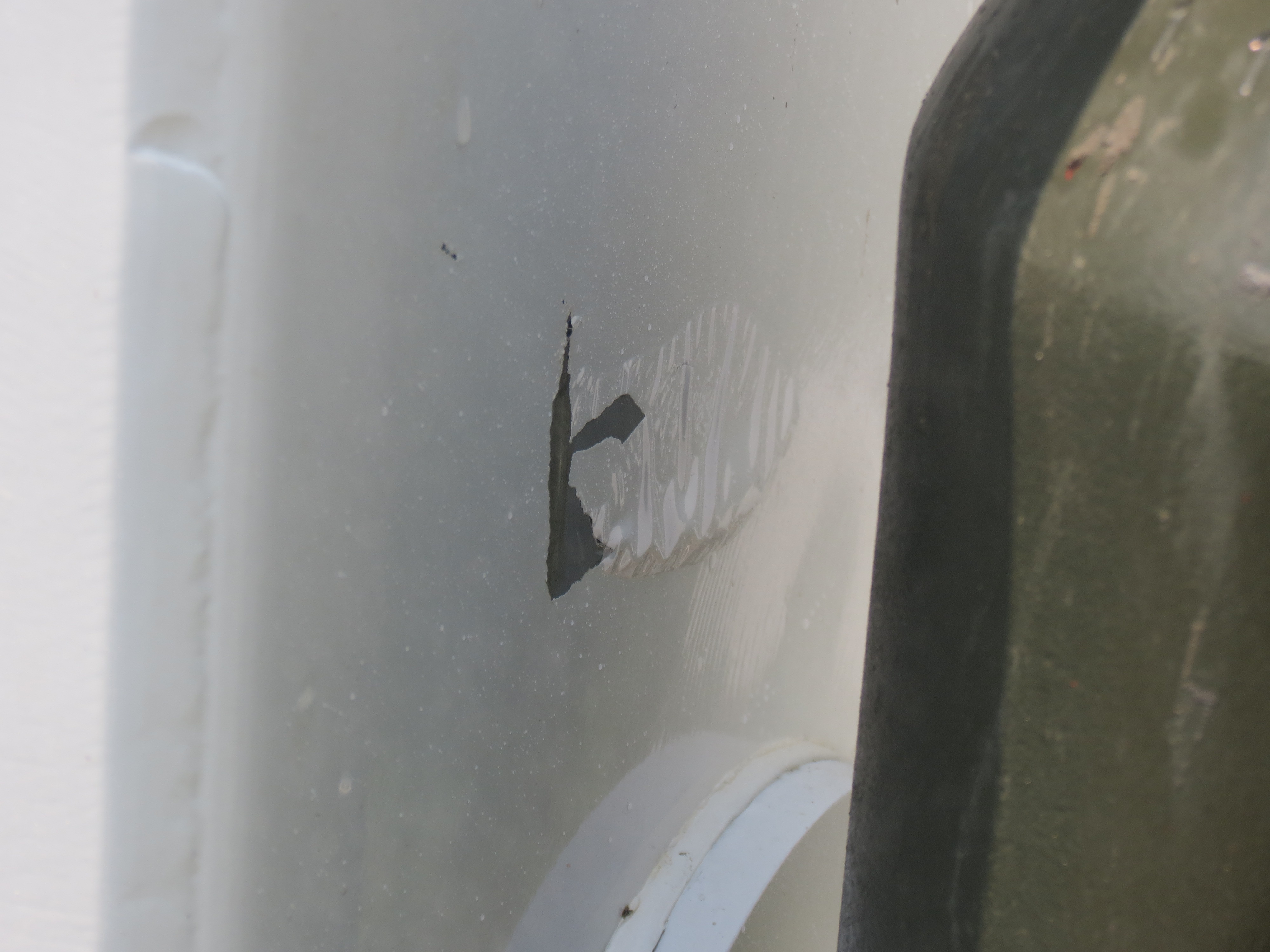

I bought a new pump a month or so ago. I spray it with non staining form oil befoe we use it. Then afterwards I pressure wash it. The paint is peeling off in chunks. The primer is staying but the paint peels like a sun burn. Does anybody else have this problem? |

The missing paint on the hyd tank the wand was over 12" away. |

You know Ed I used spray cans to touch up where the paint came off after the first use and it is not coming off. The paint job that Olin does is beautiful, it laid down great. There is a problem somewhere though. My truck does not peel. It's just strange that the primer stays and the paint does not. |

you have a paint problem , to much hardener or wasnt prepped right , surely Olin will stand up and make it right , it has nothing to do with the oil you are using are pressure washing it is most definitely a paint issue, |

I have talked to great lengths with Dave. I think the world of him, he did turn this pump out in less than 3 weeks for me. It's very hard to find the right words here. The main problem is California emissions. No good paint come from there. I was advised to not use the pressure washer. A water hose will not remove the splatters. If I tarp it the heat from the AIR cooled engine and hyd tank will kill it. I could paint it with good paint but it is only as good as what it is stuck too. |
