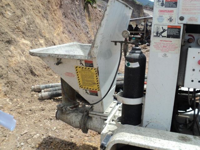

Our company in México recently bought a 2006 Olin 565 we don´t have idea how to operate, please if any can send me a manual or a reference where to get it, any help would be great |

Guys I run a 2007 5/45 Olin this morning I pumped 60 yards in a basement floor it never missed a stroke, set you surge chamber at 50 lbs you need a mix design of 564 lbs cement 1644 sand, and no more than 1300 lbs of size 78 rock which is smaller than 1/2 inch, if you set your surge chamber to high your hose will jump around if it does let out some nitrogen so it will lay there and not move,I use only 2 1/2 inch hose, you have the best ball valve pump made easy to work on parts are cheaper than a swing tube but its a small rock pump. |

I forgot something put a grate on you hopper with the spacing at 3/4 inch so if anything large comes out of the RM truck it want stop it up ,also put a 12 volt vibrator on the bottom side of your screen so it want get damaged. |
