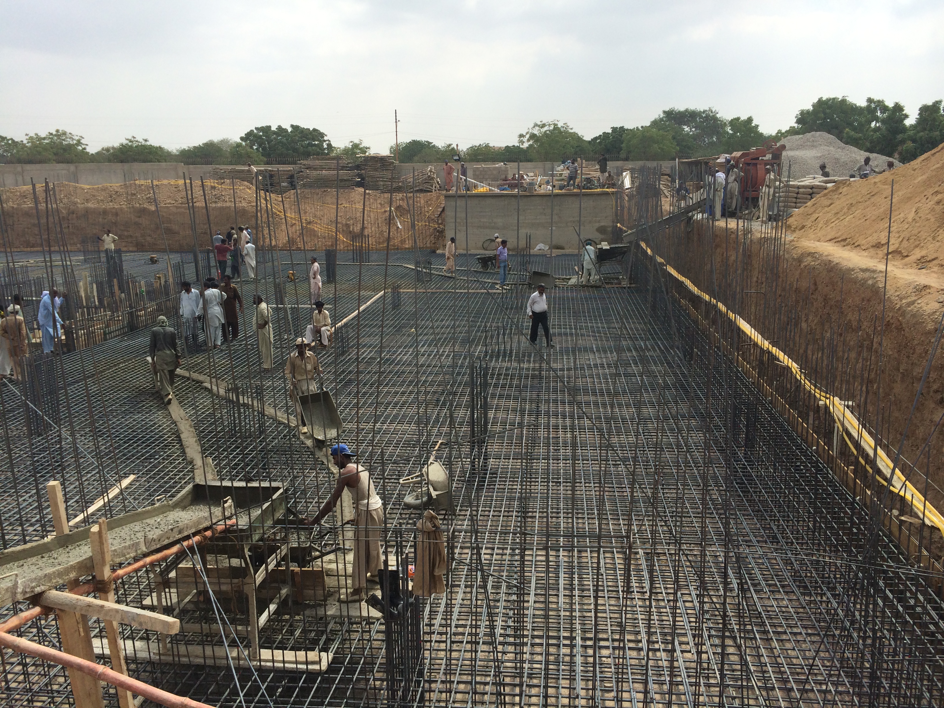

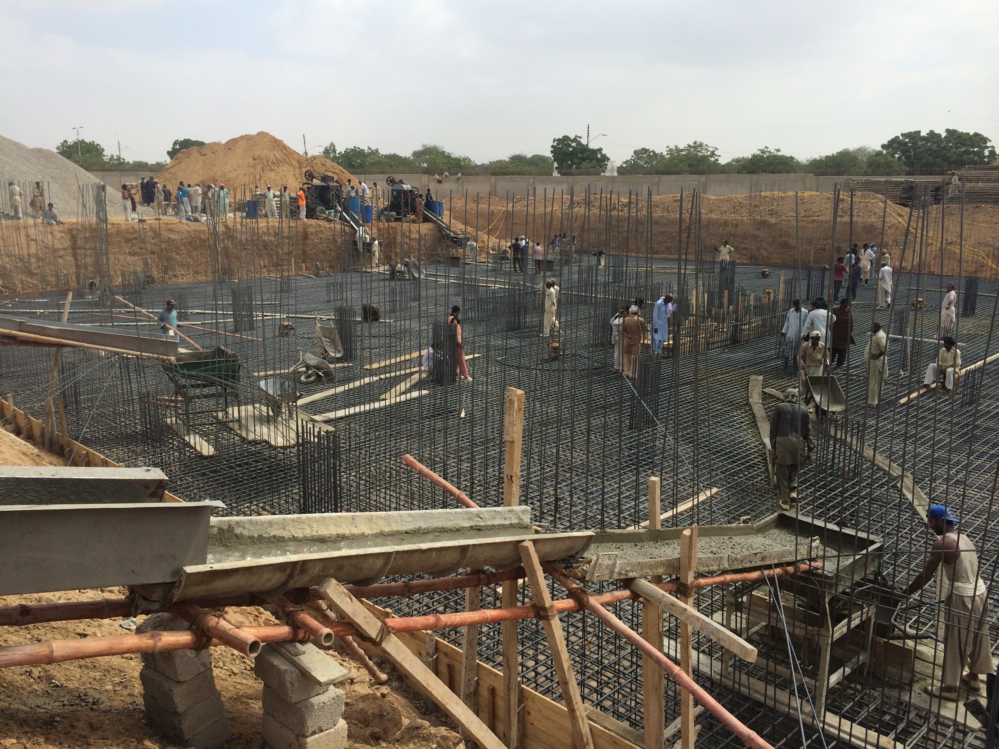

@pumpfinish Hahaha! I really liked that response! This one was a 3' thick foundation for a building (about 1,700 cbm) that got poured in 1 go (24 hours) using 6 diesel based mechanical mixers with 1000L drums. Concrete pouring labor that we have are specialized for this kind of work and are ultra rugged - there is an insane amount of work in terms of manually filling up the mixers (team 1) and also pouring it at the other end through wheel barrows (team 2). Generally, there are 30 men to a machine. |
